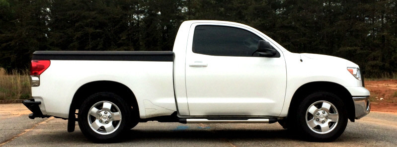

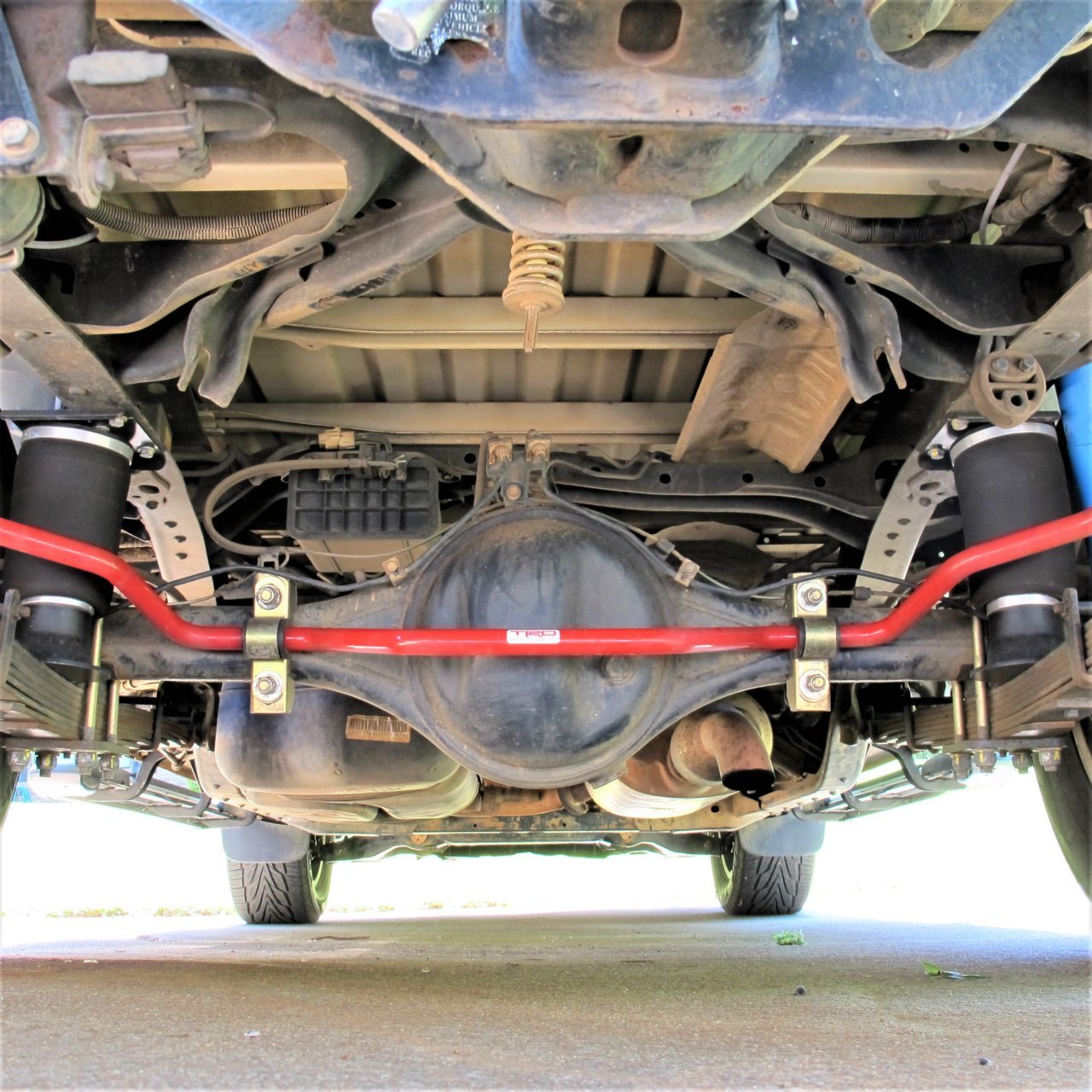

    Again, it really depends on what you do with your truck.
    Mine is a daily driver, and I rarely haul a load and I don't tow because my truck is set up as a 'sport truck' for the street. I leveled the truck by lowering the rear suspension to match the stock height of the front suspension. The leaf springs are relocated under the axle, and air bags & a rear sway bar were added.

    Does that only work with a dump exhaust? Trying to get my head upside down with those leafs under the axle, lol

    Yes, the stock tail-pipe is cut & dumped in front of the axle.
