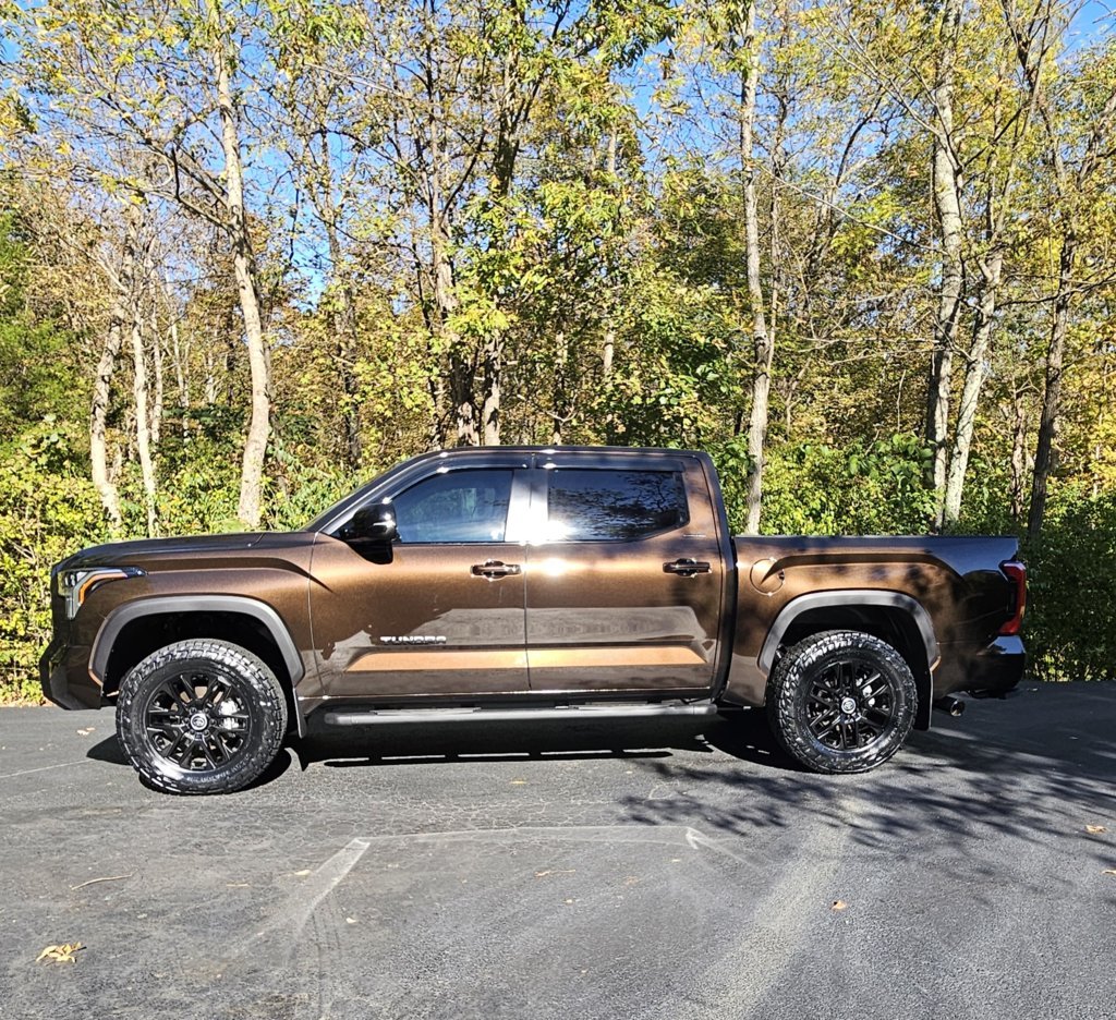

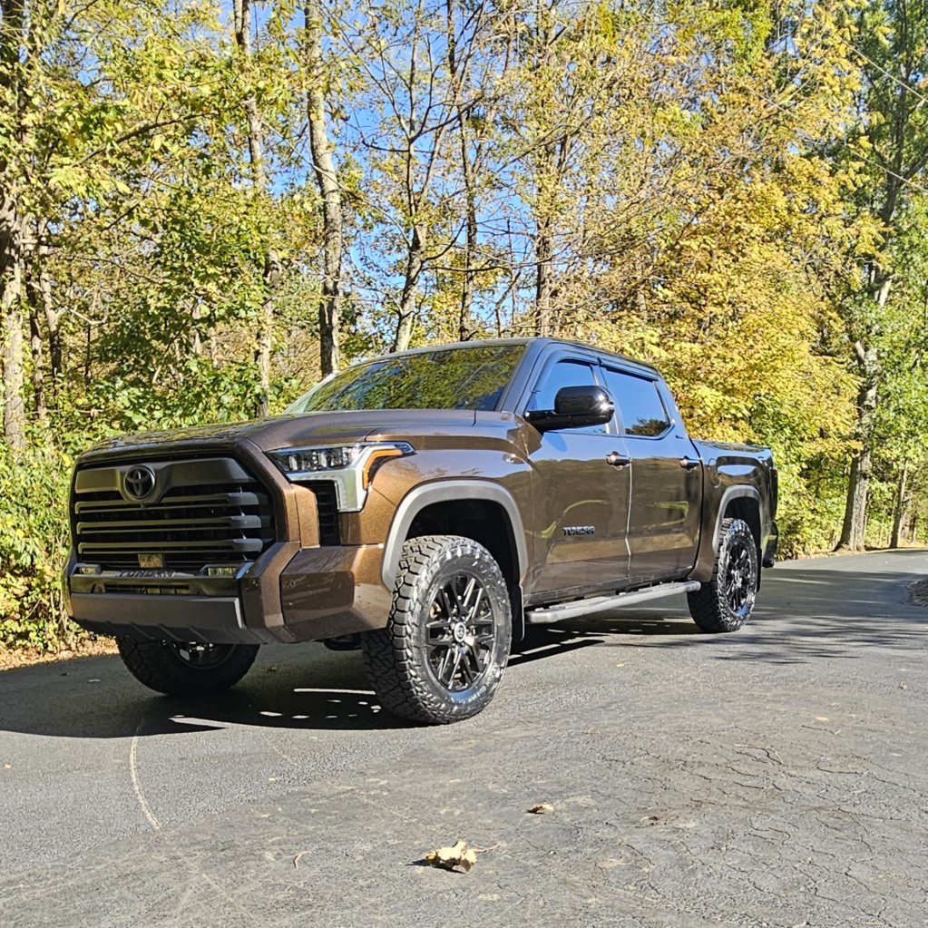

    Welcome! I have a 24 Limited, I went with a 1.75" Rough Country level in front and nothing in rear. It sits 1/4" higher in the rear now. I also installed P285/65R20 tires. I think you could go 295 from what I've read but I just stuck with the 285's & am happy with it. It still has the factory ride.20241011_155426.jpg 20241011_155441.jpg Good luck.

    beautiful truck man i love the look. thanks for the info. I think the redi lift is 2 inches so will be pretty darn close to looking like yours but in a different color. Did you by chance change out the CVJ joints? Did they have to do an alignment after the level kit?

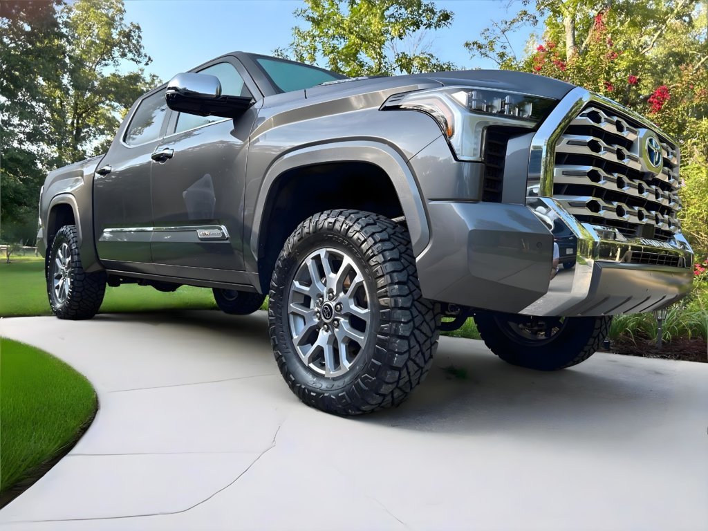

    2024 1794 Hybrid also. Dealer installed the 3.5 RC lift kit and Nitto Ridge Grapplers with LT295/65-R20. Without wheel spacers on the stock rims, it took quite a bit of trimming on the fender wells and I get rubs on the sway bars that limit me to just shy of full lock.
    I’d say you’re limited to 34” with the stock rims.
