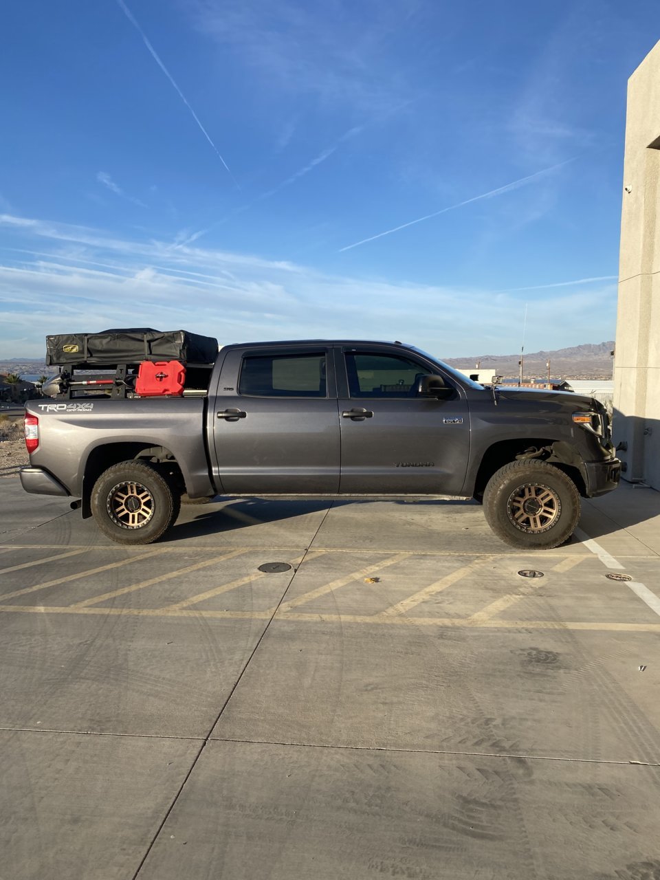

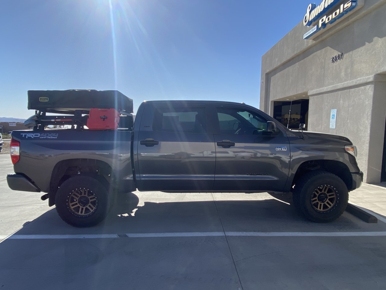

    Any pics of your leveled out truck after ? im curious because i recently bought a 2016 tundra trd crewmax stock and wanting to lift and or level but not sure which way to go yet . thanks

    Sorry buddy I haven't came back to this post in some time. I went with the Bilstein 5100 top setting in the front with stock rear. I took the overlanding route so I'm going to start looking at add a leaf kits and 5160s in the rear and the 6112s in the front. seems like its gonna be a good set up. I love the 5100s though, rides clean I don't have any issues! Defently recommended

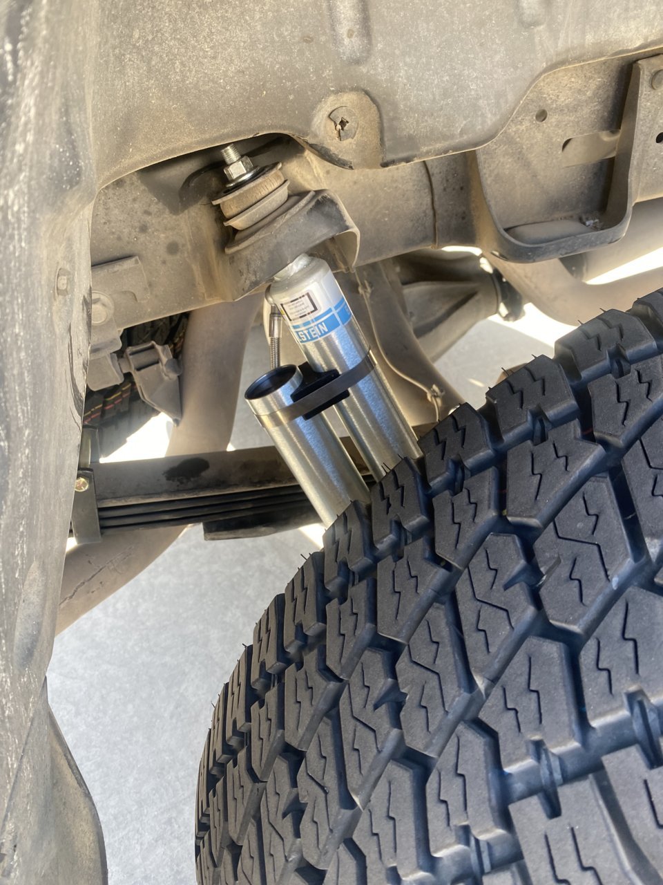

    Just a quick update yall, I ended up getting the icon rear expansion kit, and the bilstein 5160's for the rear. Love the set up. truck runs so smooth now. A little rake in the rear which im happy with because im gonna end up building a drawer system for the back.

    Interesting way to mount the 5160's reservoir...

    You know i thought the same thing :notsure:
