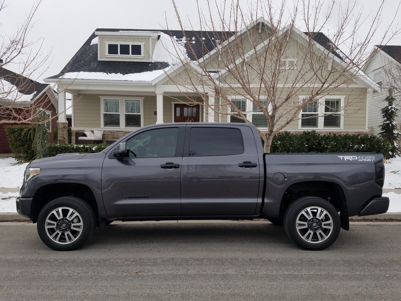

    I’m running a Rough Country Leveling Kit(2.5” on the front) on mine with 275/60R20 Tires. The ride is very smooth, I would recommend it. Here is an example of what it will look like:

    Yes it’s a spacer leveling kit for the front.

    Looks like you have a Sport.
    The OEM size of that tire is 275/55-20:
    31.9" x 10.8" with a 6" sidewall.
    I installed Falken Wildpeak AT3s 305/65-18:
    33.6" x 12" x 7.8" sidewall.
    The leveling kit will work. I'm currently running Bilstein 5100s up front on the top (3rd) clip with two shims on the driver's side and one on the passenger's side. Approx. 3" lift.
