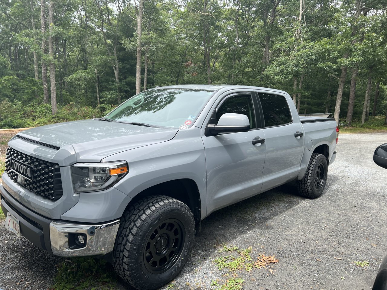

    X2 on Billstein 5100’s. Only had mine in for a few weeks so still early but I think it rides great. I really don’t notice any difference really over stock as far as harshness goes. Maybe slightly firmer but that’s all. I’d bought a shim to install in driver’s side but I took a while for shipping and didn’t get it in time. Just got my
    Wheels and tires mounted and balanced today. 285/75-18’s on Method 705 wheels
