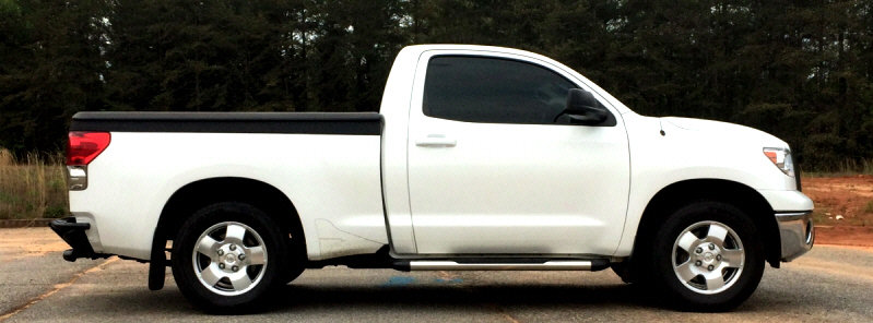

    I used one kit to lower the rear so that it matches the stock height front end.
