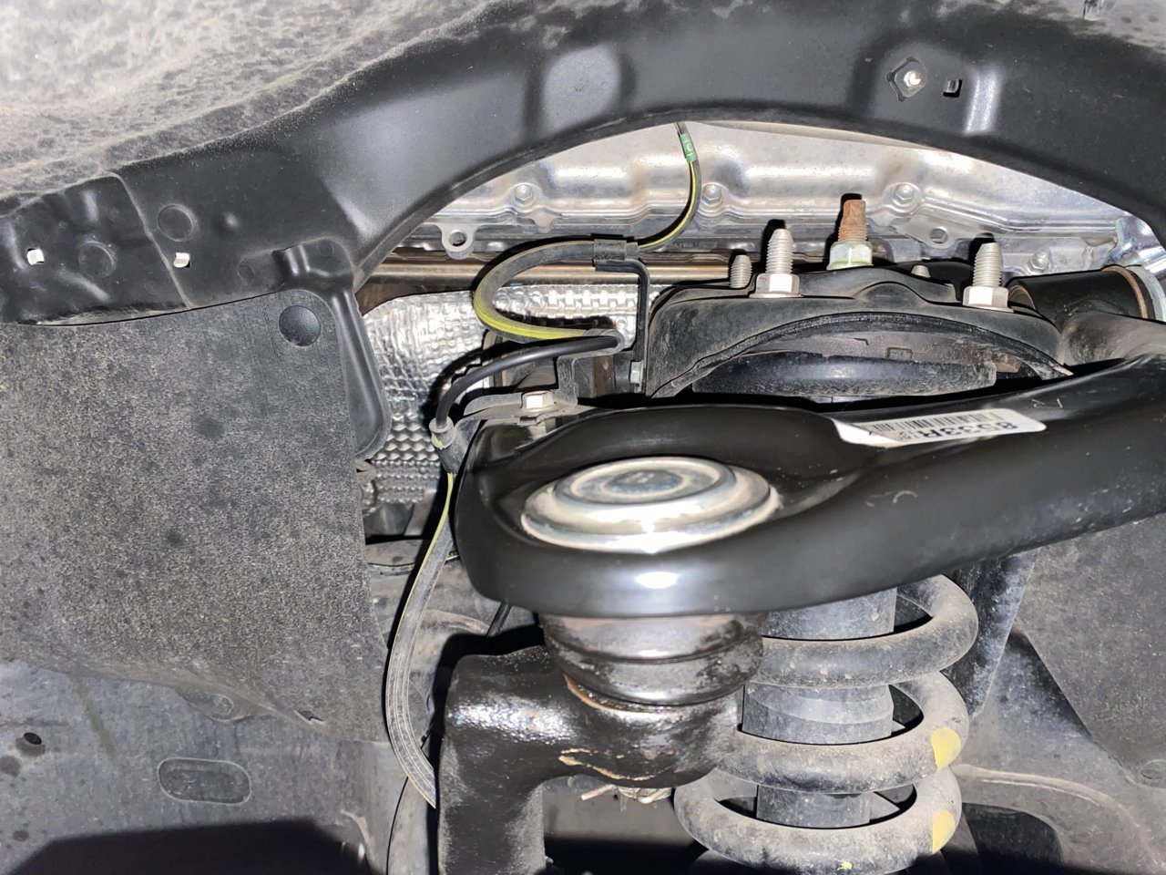

    Have Toytec coil overs coming but I was looking at the stock UCA’s because I was planning to grease them when I did the install but I don’t see a zert....are these sealed and are just done when they are done or is the way to grease them?

    Sealed.some guys get a grease needle and slip it between the boot and squirt it Into the boot but that’s a bit janky if you ask me. You might as well get yourself some UCAs with a serviceable ball joint.

    Yes exactly. Let them get crusty and when they need to be serviced replace. I bet there’s all kinds of guys on here with stock upper control arms sitting in their garage collecting dust too. Have a great day my friend.

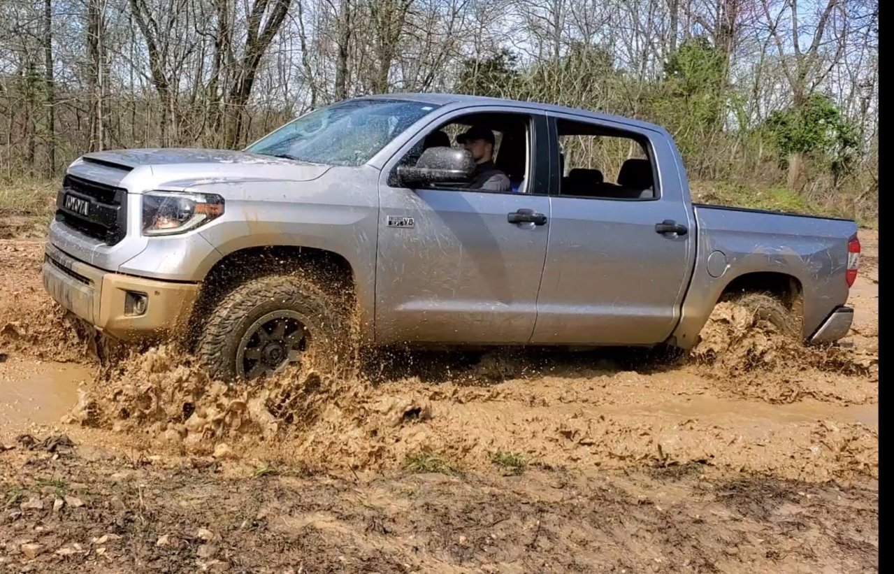

    I have done spacers, 5100s, and OME 612s on various Tundras. Currently running 5100s on middle and wish I had sprung for the 6112s or the OME 612s as I've recently started actually going offroad a little and want more aggressive lift and tires. Definitely don't settle and save for what you want.
    Shameless pic of 5100s and 275/70s on my recent trip that convinced me I need armor and higher lift and bigger tires. Tundra did great but I was jealous of all the stuff my Jeep friends could do.

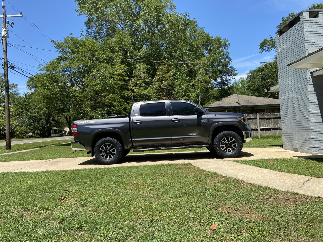

    5100s top setting wrapped in 295/70 Nitto RG rides comparable to stock

    No but I’ve toyed the idea of getting some. Researching it now. It is really close to by UCAs but hasn’t effected anything. I’m only 1 day in since i had the setup done. I appreciate it thanks

    I didnt put any spacers on my stock TSS rims and I had 35s on them
