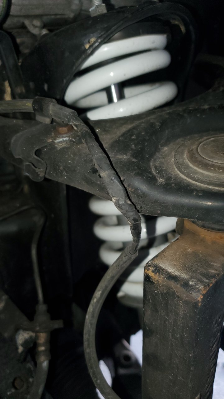

    Check the front. I did the same thing to my truck when putting on the lift kit pulled and broke the abs wire that's where I would check first.

    You can see where we just spliced it back. Been that way for 2 yrs .I have been thinking to order a new cable just have not got around to it. 15529974816703255263668977325180.jpg
