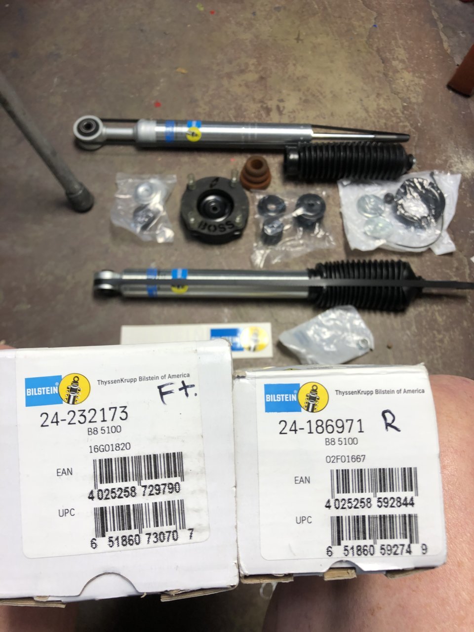

    Looking for the part # for the Bilstein 5100 adjustable for the front !! For a 2020 Tundra Sport crewmax. Trying to level the front end and from what i been reading the shocks are better to do then the spacers ?? mostly street driving and some beach off roading

    Definitely a better choice than spacers. Ride quality is tops!

    Here you go and they look like this. I still need the strut coil springs which will be manufactured on Sept. 19th so the factory says.
    Scored leveling spacers too
    Boss 1/4 ones from another member.
