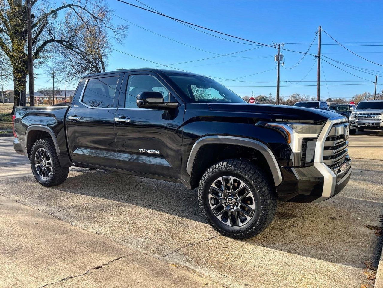

    I did the Rough Country 1.75” leveling kit and it would most likely fit 35s on the stock 20” rims. My tires are technically 34.65 x 11.5.

    My numbered size is 275/65R20 for these Cooper Discoverer Rugged Trek.
    All the same numbered sizes are not equal though, as can be seen if you research by each brand/model on tire size.com
    My dimensions are 34.65” x 11.5” whereas if you had the KO2 in the same numbered size the dimensions would be 34” x 11”.
    The KO2s in 295/65/20 are 35.1” x 11.8”, slightly less than half inch taller than my 275s and 3/10” wider than mine.
    Oh and I really can’t tell much as far as road noise.
