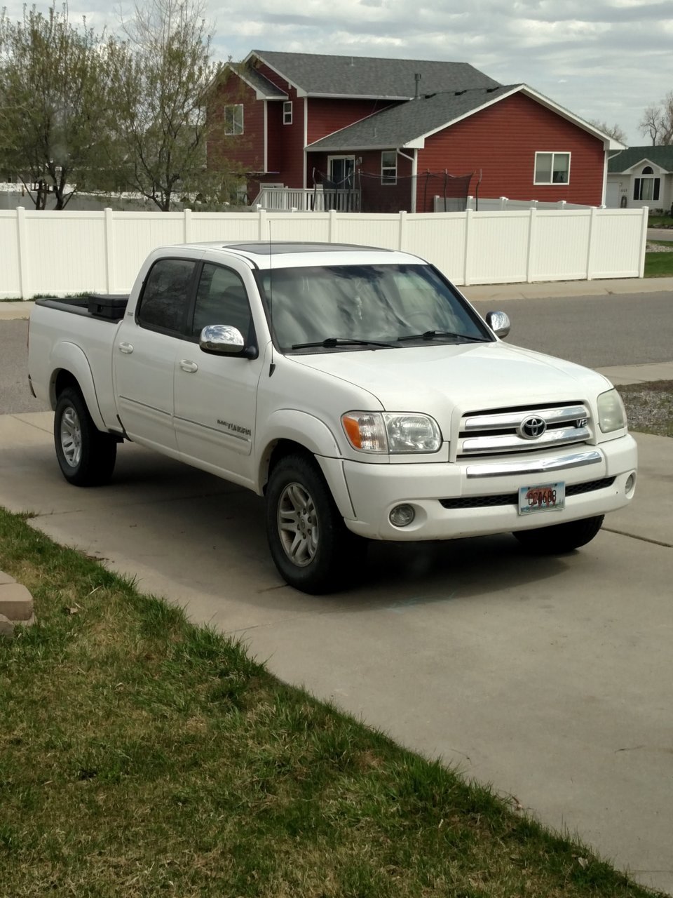

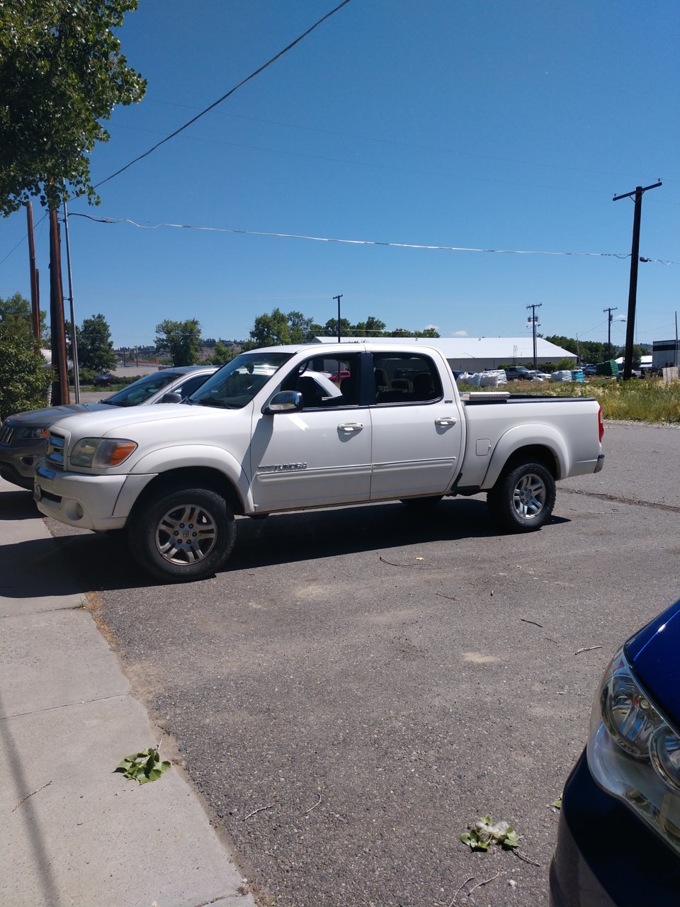

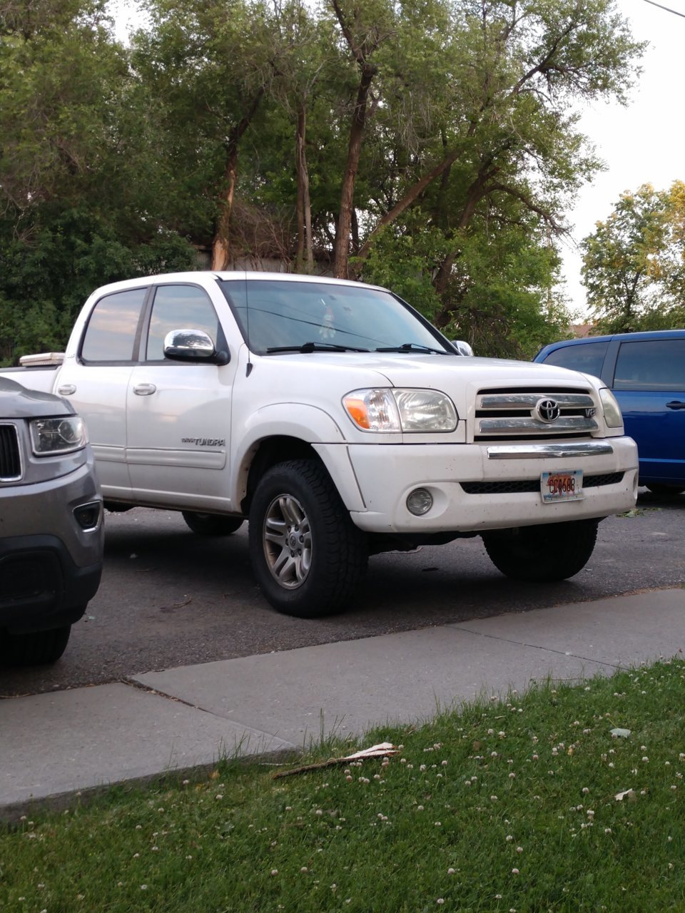

    I just got done putting a 2" leveling kit on my 2005 DC Tundra. I also changed the shocks and coilovers while I was at it. I left the rear alone because I just wanted it to be more level in the front...nothing else.
    I went with Supreme Suspension's 2" spacer and it still rides nice and soft, but not too soft. It's still just about 3/4"-1" high in the rear, but if I have to put a heavy load in the back, it won't squat in the rear...
