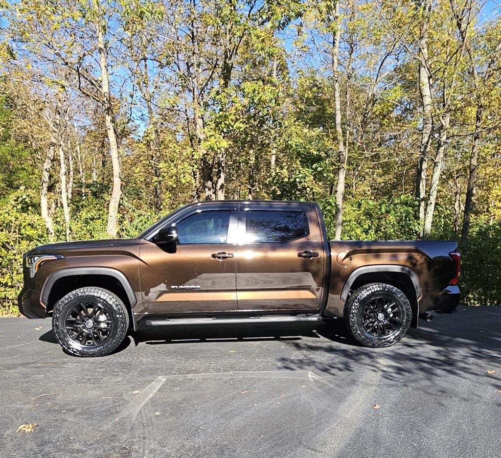

    I researched this before doing mine, the preload spacers from what I read can give a harsher ride. I debated on the whole starts assembly but just wanted a level. I ended up with 1.75" spacers on front & nothing on rear. It didn't change the ride at all & leveled the truck perfectly. I later added 1/2" in rear just so it wouldn't look squatted if I had anything in the bed.

    Rough country. Then I later added Cornfed 1/2 to rear.
    Just depends on what you want out of it. I don't do offroading but just wanted it to ride good & be level.20241011_155426.jpg

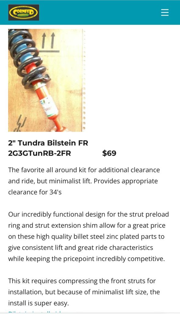

    I know both Westcott and Cornfed are well loved by the Toyota community, is thee any reason anyone can see to go with the Westcott at $325 vs Cornfed at $69? They're both 2in, both preload + shim up top. It's not about the money, more so if there's no reason, because if there's not that's almost 1 of my 4 new tires, lol.
