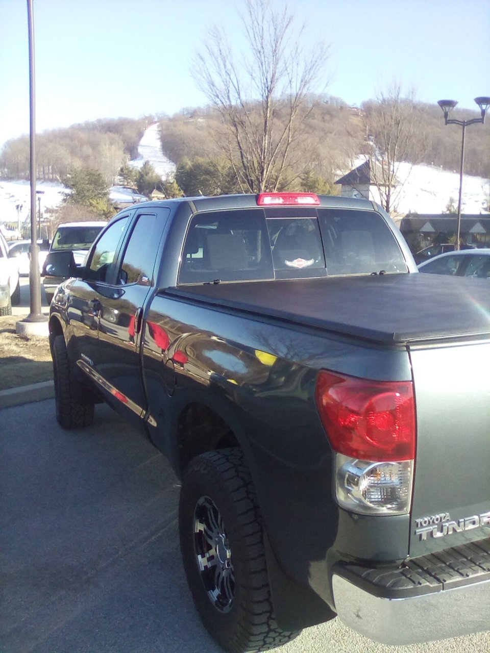

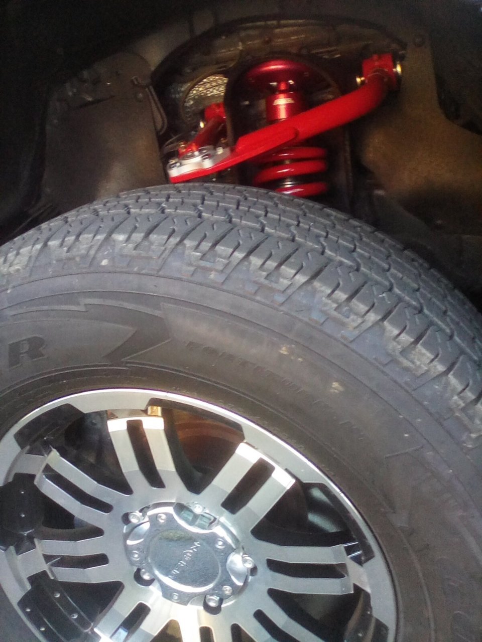

    Exactly the route I ended up with... Toytec is solid and true.. Great CS and staff to answer all tech tips. Simply awesome.
    My 2.0 TT Aluma series set from factory at 3"/read 1.5"
    edgewardoe[QUOTED] likes this.

    toyofan87 did you have any problem with the front lean after installing the toytecs?
