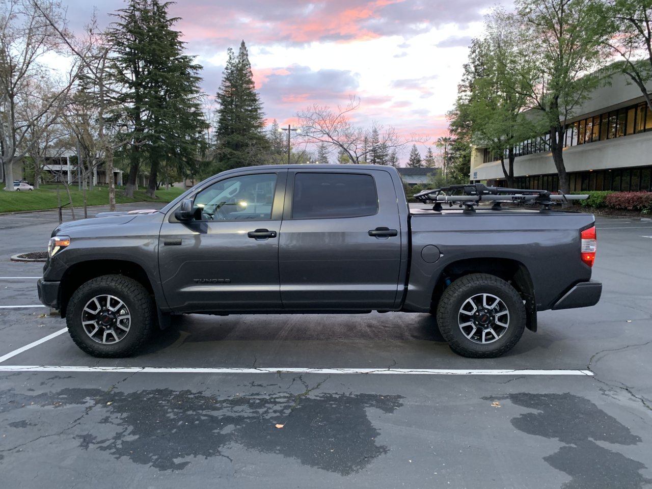

    I have a 2019 sport. First think I did was swap out the 20" for 18" wheels and went to 275/70/18 tires. That made it ride better - less rigid feeling. Then I added the 6112 @ 1.9" up front and left the back stock. I actually don't notice a difference in ride quality on pavement after the front suspension upgrade, but it should do much better off road.

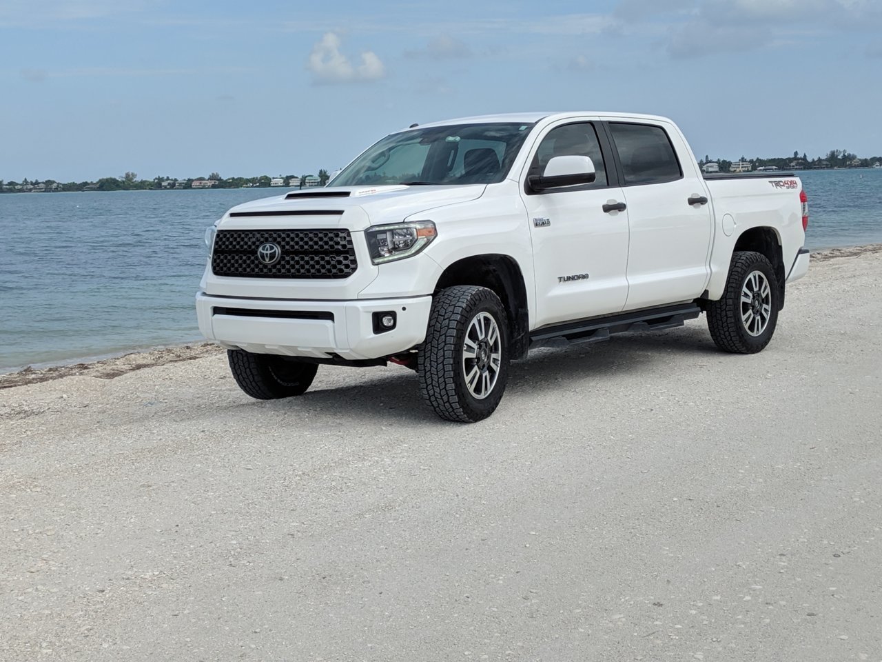

    I only had about 1.5" of rake before the leveling. It is interesting how the trucks differ. With my 3.0 in front and 1.5 in back, I am exactly level. I don't remember the exact measurement, but I think it was 26" from center of hub to wheel well on all 4 wheels, give or take a 1/8" between them.
    This is probably the best level ground pic I have: It's not exactly a side pic - I will see if I can find more.

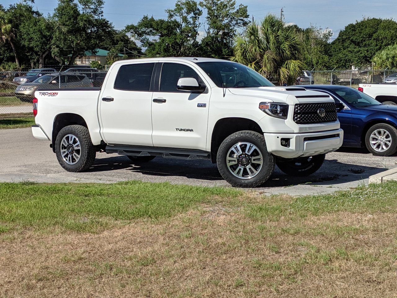

    2022 MGM XP-Series CrewMax 4x4
    Better side pic. I just measured; 25" at all 4 wheels.
