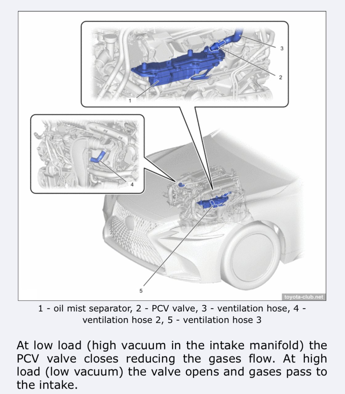

    The V35A definitely has an air-oil separator from the factory.
    this is an example of the one from the LS500 with dual throttle bodies but it should be the same layout for pcv.
    DFS likes this.

    I think that is an internal oil separator for CCV, not PCV. It would not be beneficial to have a CCV catchcan, but a PCV catchcan would probably catch some junk. Unless that is somehow doing both?

    CCV and PCV are the same thing. The air oil separator is between the crank case and the pcv valve and its intention is to catch whatever oily junk. It’s not as good as a catch can though but I think this engine doesn’t need it due to dual injection.

    My understanding is that CCV and PCV do the same job, but differently. CCV is not a valve but an orifice that allows a constant limited flow of crankcase gas to be pulled into the intake. The PCV is a one way valve that opens when the manifold pressure drops such as when the throttle opens. The 3UR for example has an internal oil separator as well for the CCV side, but not for the PCV. When people install a catchcan on the CCV side it doesn’t catch anything, but the PCV side catches a lot. Perhaps the V35 does in fact utilize an internal oil separator that filters out the vapor for both the CCV and PCV, but I don’t know. That drawing kind of makes it look that way? I guess it depends on if their PCV nomenclature is correct on the drawing or if that should actually be labeled CCV.

    Does it really come up from the center of the block into the bottom of the manifold? Seems unnecessarily annoying and difficult to access if the PCV were to have an issue.
    I also dont see the turbos in this diagram. Do the lines labeled 10 and 11 leave the intake after the turbos, so they are pressurized to the same pressure as the charge air? Wouldnt that mean the crank case was pressurized?

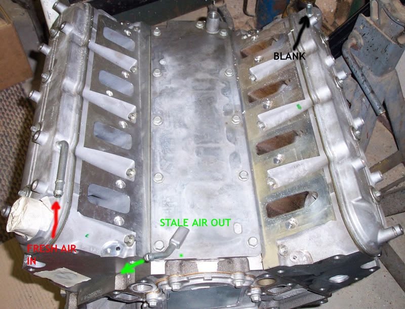

    nothing out of the ordinary having the pcv there...LS6 engines had it back in the day...very easy to service

    Sure, if its just a simple barb. That diagram makes it look like a fixed connection under the manifold with a "catch can" and PCV stuffed in there.
    an SBC is also a very simple setup compared to a turbo motor that needs to be able to have a functional PCV while the manifold is under both vacuum and boost. Its not really comparable.

    The Tundra has a single TB after the intercooler. If they still have the system setup like this though, a catchcan would be virtually useless.

    I guess it’s under the intake manifold in the vee. I can’t tell from this image.
    From what I can tell, #10 ventilation hose in the previous images that goes to the valve cover is before the the turbo so it’ll make vacuum at high boost. The diagram is definitely missing the turbos.

    Yeah the first diagram that was posted has to be wrong otherwise they would be feeding thr crank case 15 psi
