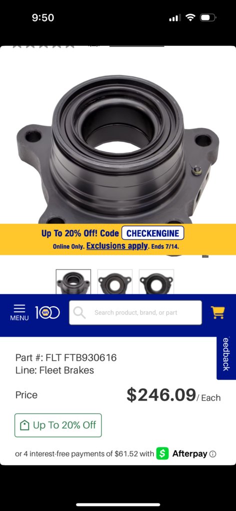

    @ColoradoTJ used the term axle bearing. Sounds like @koditten is referring to a wheel bearing. Are these the same thing?
  8. Jul 14, 2025 at 8:42 AM
    ColoradoTJ
    Feb 24, 2016
    #2766
    40,893
    I'm thinking we are talking about the same thing.
