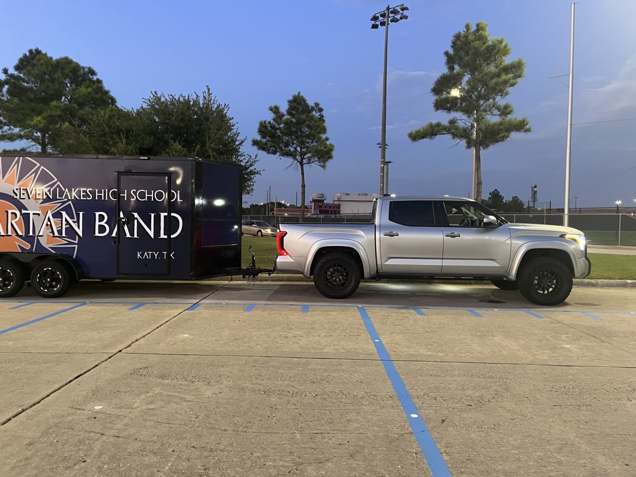

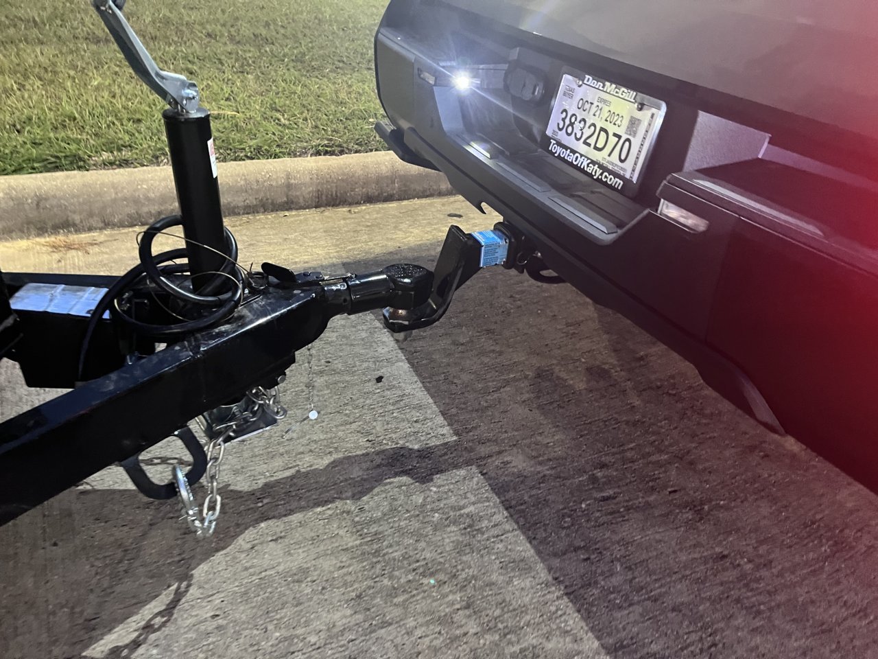

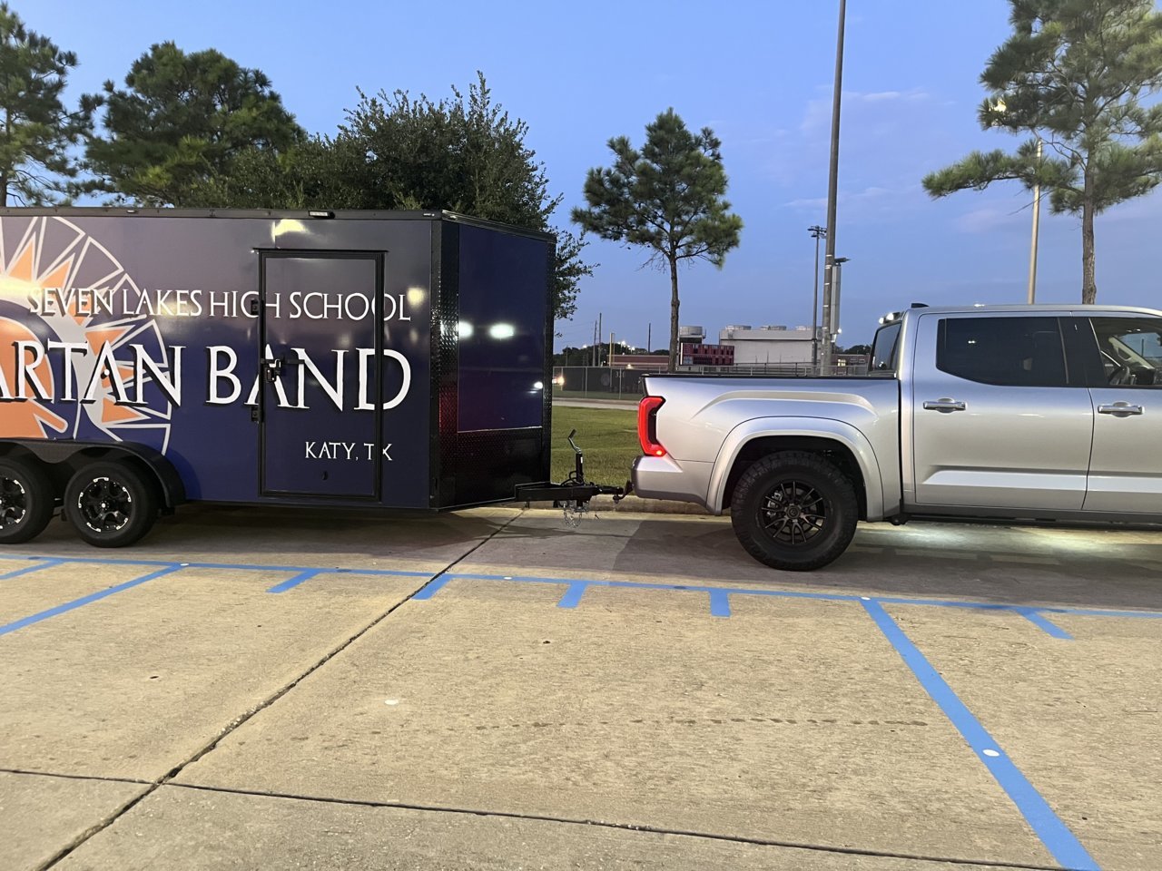

    A few photos connected on trailer. Trailer is empty. 2AC91658-DCB5-4453-A56C-6CB5B13AA6B4.jpg BCD69548-CA33-45C7-B54D-A7121A7C5659.jpg BCDFDF41-BF33-4580-8010-0F811DC0646C.jpg

    That looks pretty good! Typical squat but not too bad.
