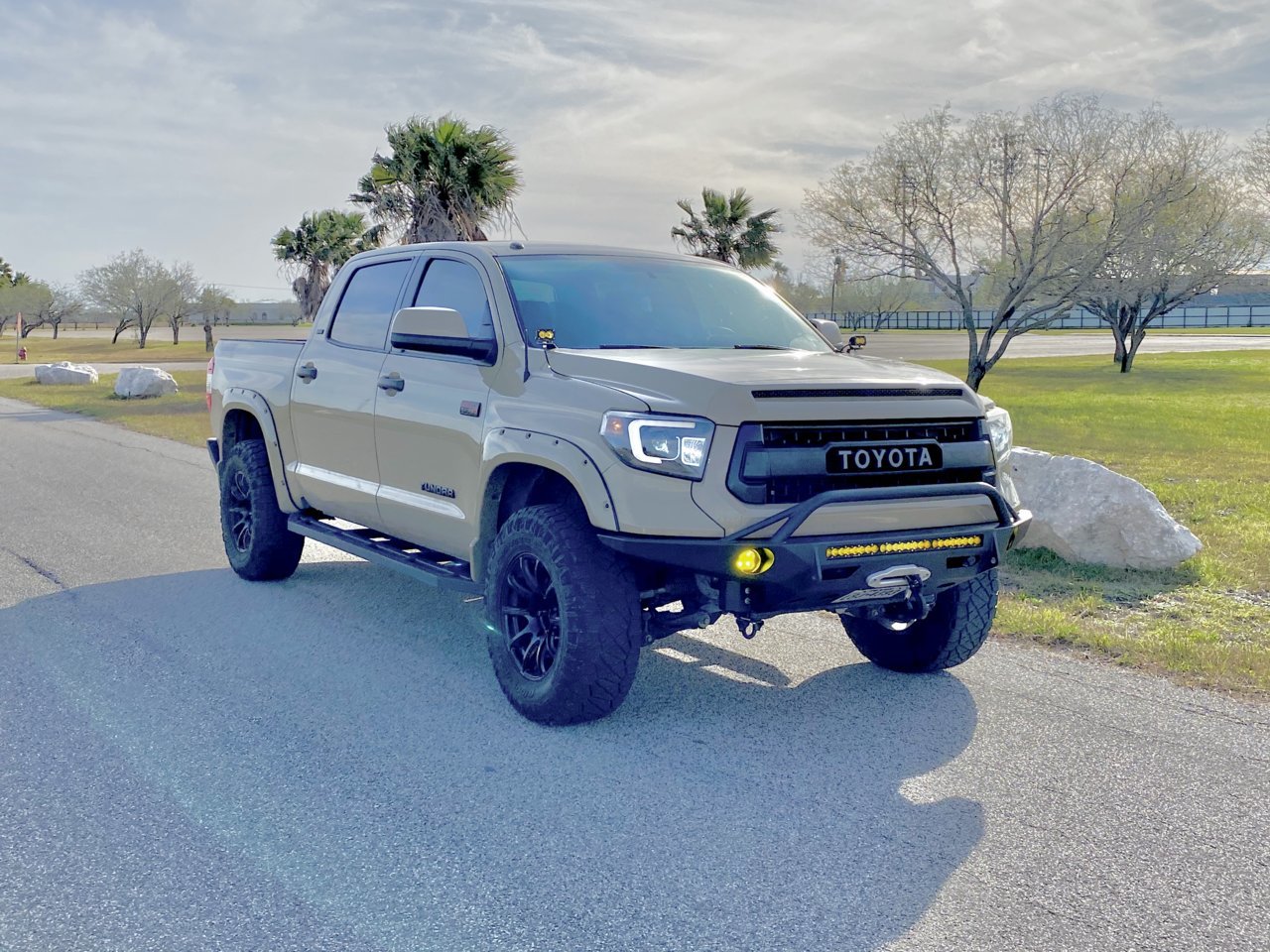

    before the new bumper it would rub on full turns pretty bad.

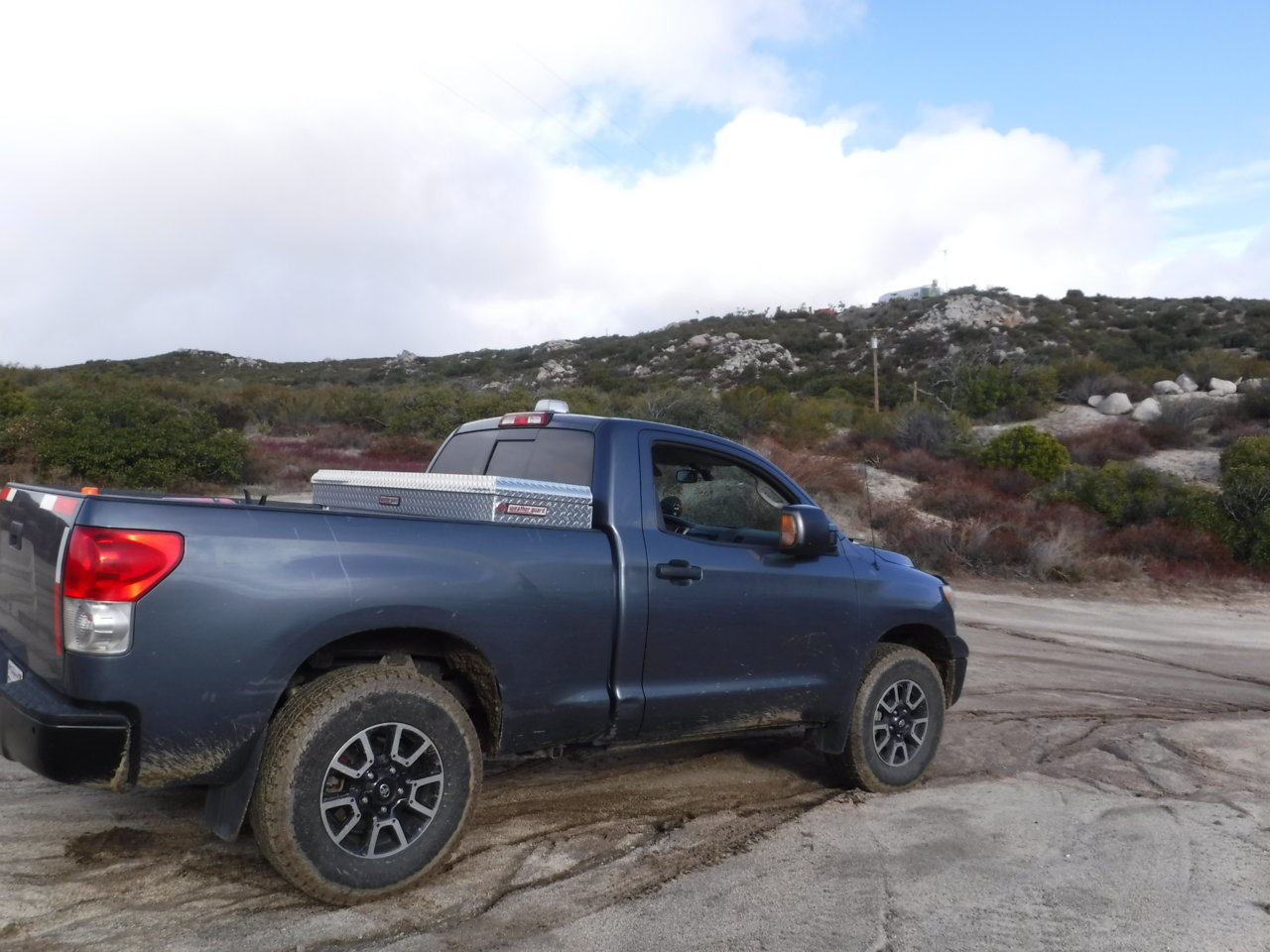

    I run LT285/75R18 tires on stock 18x8" wheels with ~1.5" of lift in the front and no lift in the rear. I have done no cutting and experience no rubbing as the suspension articulates and steering is turned to full-lock.
