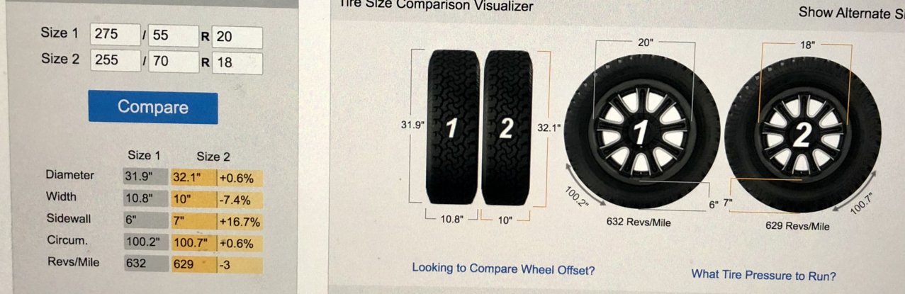

    Ya, i have never had to crawl under to check the size, or look at the door- previously the spare rim was a doughnut of equal diameter or the full-size has been of equal size.to the other 4 tires even the sales guy was bedazzled when I asked him. It might be common knowledge to most people on here but certainly not everyone.
    apparently, the spare is on an 18 but the tire itself is a larger size so it still is similar in height for driving purposes???
    original 4 tires were 275/55/r20
    the spare is 255/70/18---
    i just don't understand It

    ya I plan on it- I guess my confusion is why is the spare different? its not cost as the dealer/manufacturer pass the cost on to us, the buyers.... it can't be the size, as to their stock tires are of relativity equal size,,,

    It definitely is cost driven. There are very few people out there that would want to pay extra for a 20" alloy wheel as a spare. The vast majority of of buyers don't want to pay extra for a wheel and tire that is going to sit under the truck unseen for the majority of its life.
