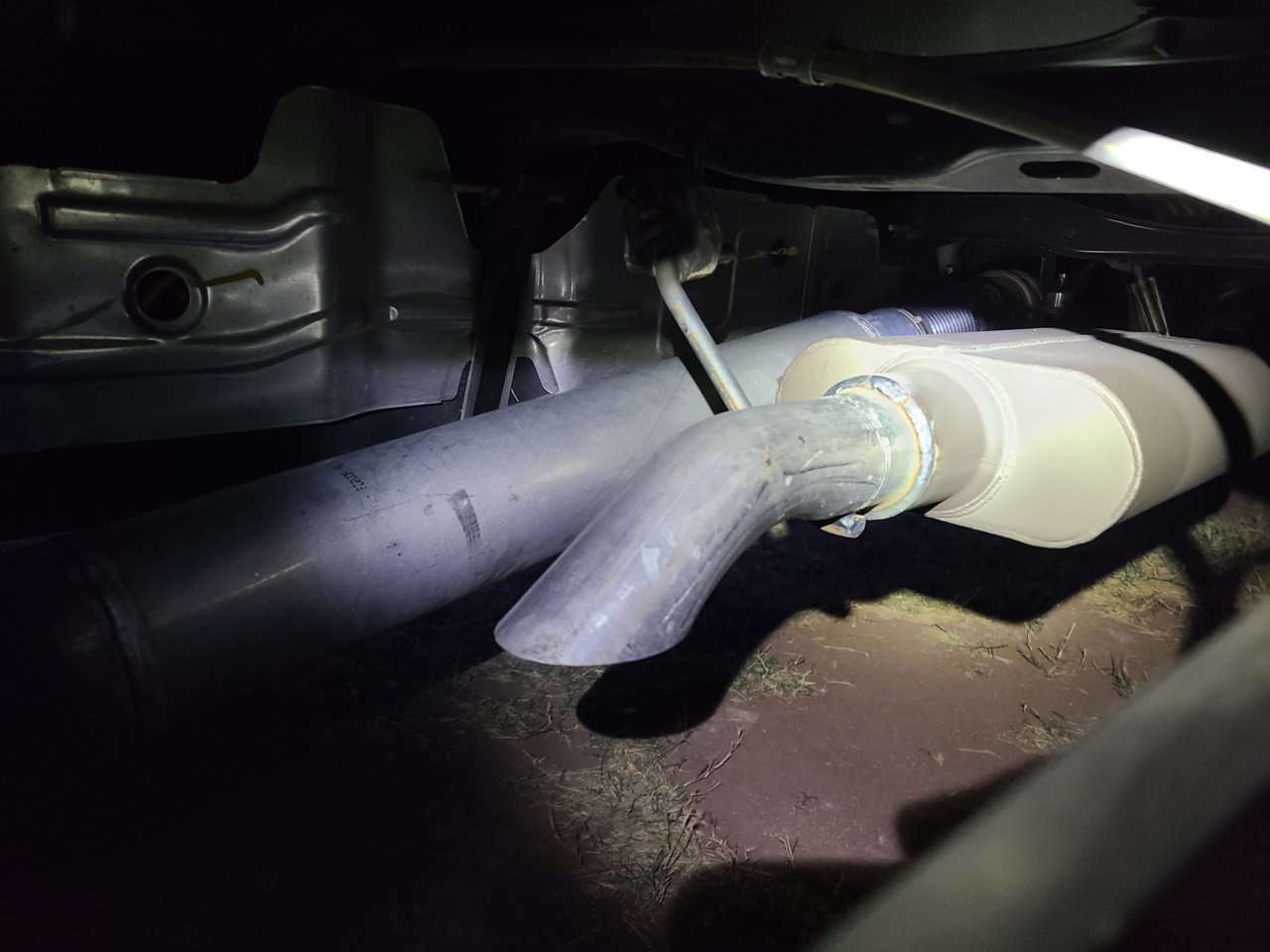

    At the recommendation of @Black Wolf, I purchased a flowsound 8424553 for around 45 shipped. I paid 90 dollars to have it welded in and a turndown and hanger added. So 135 bucks total.
    It added the v8 sound, no droning noticed over a couple hundred highway and interstate miles, and could be mistaken for a nice sounding factory truck. I especially enjoy it driving around town. At highway speeds, I can't notice it, like I wanted.
    I could have dealt with a little more volume, but I'm glad I went this route. I haven't noticed any loss or gains in performance (wasn't concerned about this, feels plenty peppy still), it's out of the way for offroading and not toasting my 35" spare, and costs next to nothing. You don't have to spend piles of cash for an exhaust upgrade unless you have super specific criteria or want to buy for the name or brand.

    Nice, looks like a Flowmaster clone. Any idea which FM model this would be comparable to?

    It is 100% a Flowmaster clone, apparently their patents expired, but unsure which model. I always used super 10s since I was a noise junkie.
    Keep in mind, if you are a noise junkie, this won't be loud enough for you. I am sure it will get slightly louder after awhile, but it is a fairly quiet system. And I really enjoy that for once.
    They might have a different version that is a clone of a different Flowmaster, I just haven't seen it.

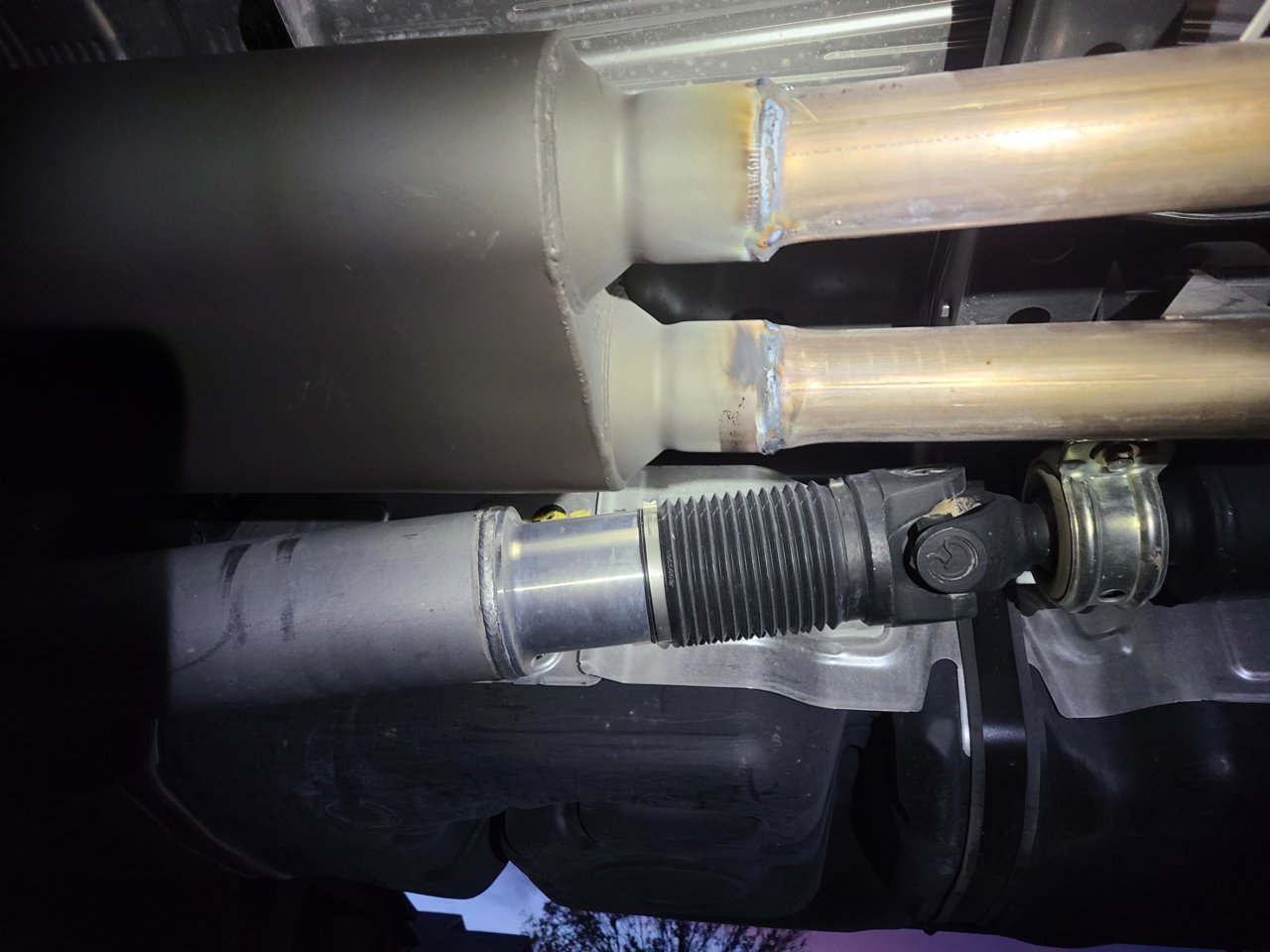

    Wex dont worry about uploading a video if it. Is the muffler just as long as stock muffler? Id like to weld it into the existing tailpipe if it'll fit.

    It's about 4" shorter than the bloated factory muffler.
    17 ish vs 21sh"

    Wex, I took your advice and bought the flowsound muffler online for $50 after shipping and taxes. Bought a 4" pipe reducer for $5 at Oreillys and I'll need to replace a sawzal blade. But for $60, I welded the new muffler into the existing tailpipe, and even used the hanger off the stock muffler.
    The system sounds great. Just a little throat at startup, just enough growl at climbing speeds to make you happy you didn't overdo anything and hardly any drone at all. I recommend the flowsound muffler.
