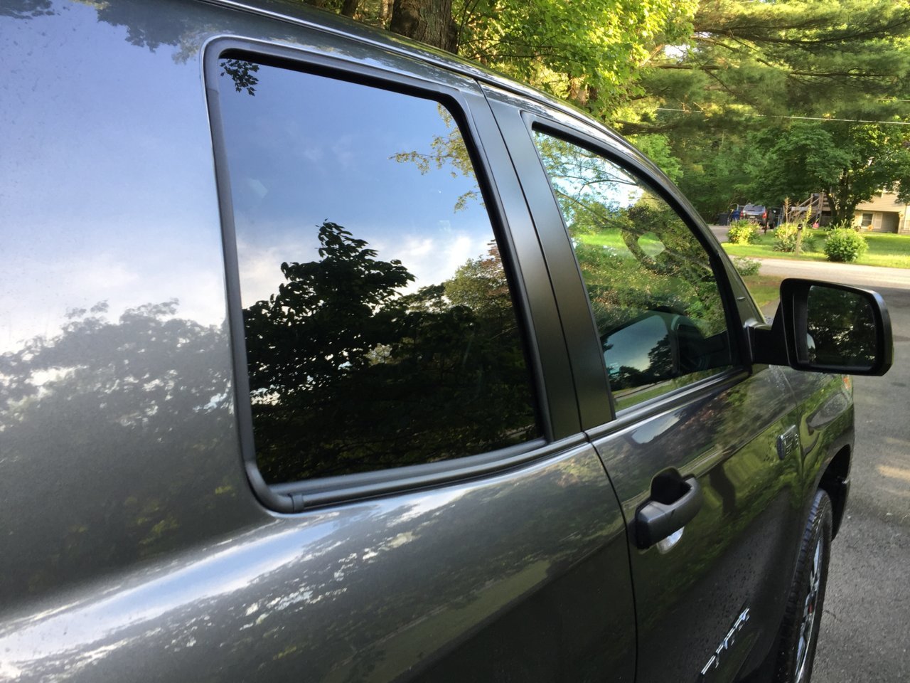

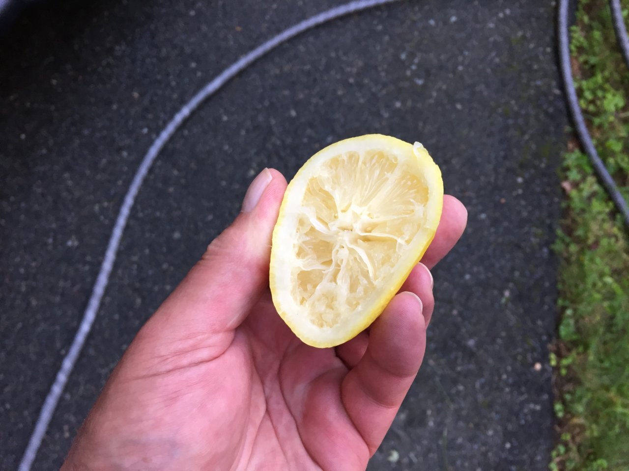

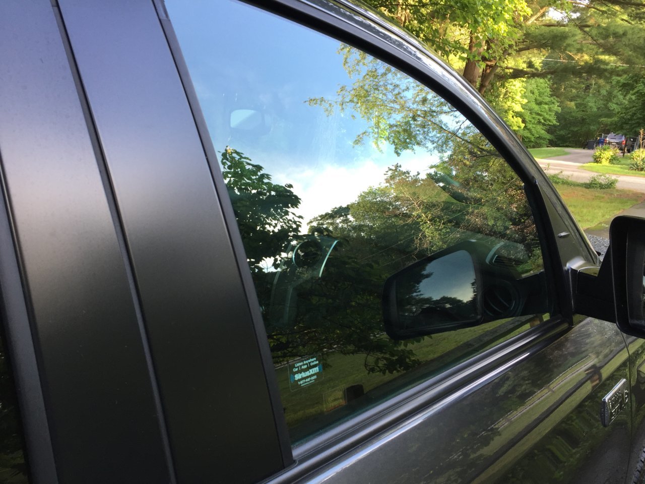

    Had the worst hard water spots on all my glass and nothing I had in the garage would remove them. :( Was just about to order something from Chemical Guys when I remembered an old trick I heard about, a Lemon. Didn't really think it was going to work, but much to my surprise, it did an amazing job. After giving the glass a good cleaning, use a half Lemon and rub down the window while slightly squeezing out the juice, at first you will feel a slight resistance between the Lemon and the glass, and then after awhile the resistance goes away and feels really slippery. Hose off, dry with a good Micro, and you're done. Hope this helps. :)
