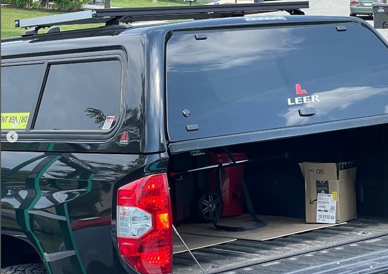

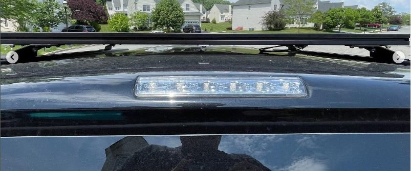

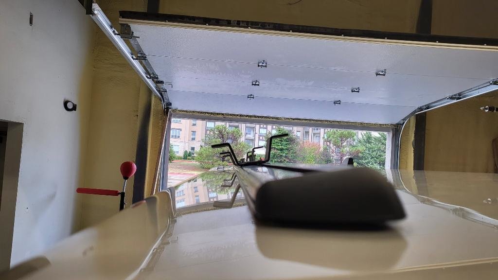

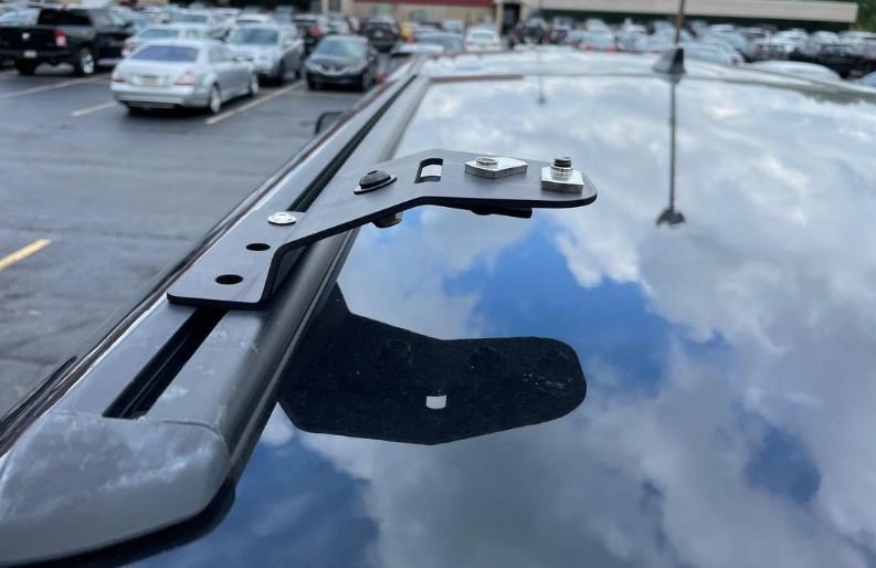

    that is BS, my LEER 100XR came from factory didn't look like yours. and I was able to mount my 80/20 bar on top.
    I got mine directly from LEER outlet.
    Hope the pictures help.

    Thanks. I had the dealer switch them around to face the same way as yours and it worked fine with the Prinsu after that.
