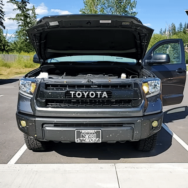

  13. Jul 20, 2020 at 4:29 PM
    100LL
    100LL [OP] smells better than Jet-A
    Feb 15, 2020
    #42649
    367
    NW Oregon
    2020 SR5
    Potatoes.
    MrPalladium likes this.

  15. Jul 21, 2020 at 5:48 AM
    Scoobyvroom
    Scoobyvroom New Member
    Mar 3, 2020
    #43414
    42
    2020 Tundra Limited
    In the process of de-chroming....
    Reason for no hyper flash is because your are using the hazards. Did you try just the turn signal? Either that or you are right on the verge. I bet if you do the rears you will need resistors. I'd hang onto them. Looks like you got the base figured out. The 3156 bulbs have the ears to clip in, the 7440 don't.
