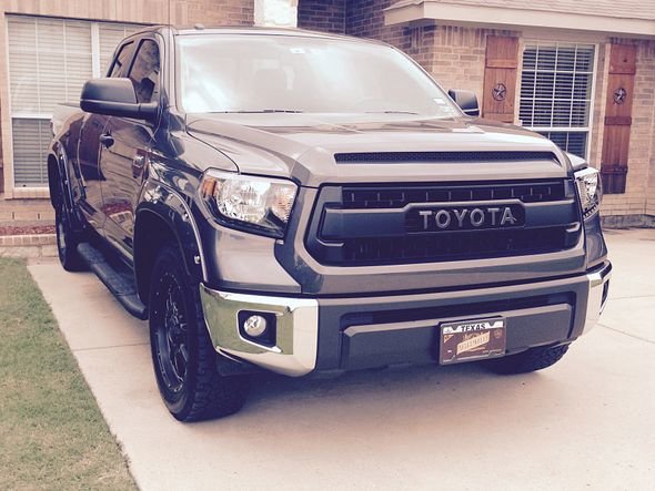

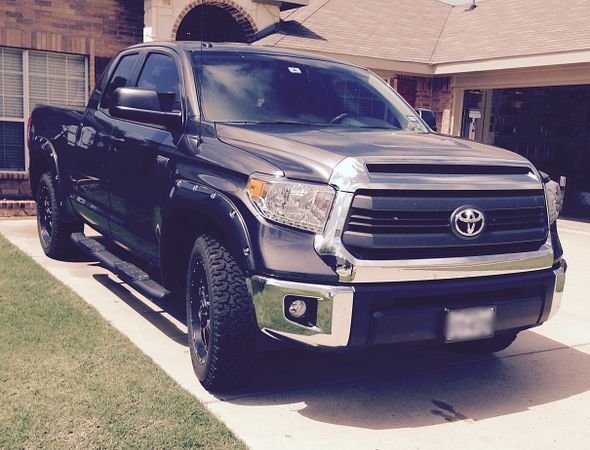

    No, I read your entire post.
    From reading about LED bulbs in halogen houseings my opinion still stands.
    The pattern and light scatter are terrible, plus oncoming drivers will hate you.
    But the biggest issue will be your disappointment of the halogen housings, they are ugly.
    I can't tell if your truck is silver or MGM.
    Perhaps you can find some TRD Pro halogen headlights.
    Good luck..
    Stock Halogen
    TRD Pro halogen
    TRD Pro OEM LED
