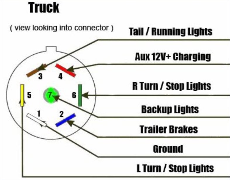

    Welcome from NY.
    Do you have the tow package? If so the easiest way would be to tap into the back of the plug.

    Thank you for your help, yes there is a tow package on my truck. I will definitely take your advice.
