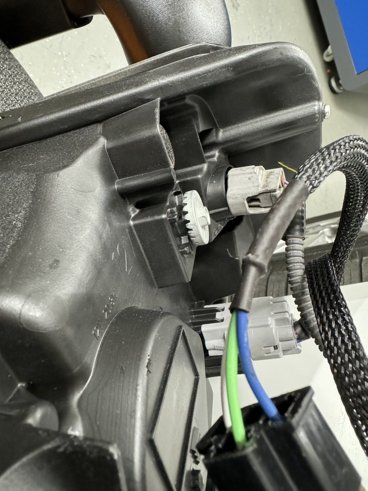

    Installed the TRD Pro LED headlights on my 2014 Platinum using @iHacker harness and both his product and instructions were flawless.
    After adjusting the lights vertically, it appears the passenger side needs to be adjusted to aim it horizontally to the left.
    I thought I read in another post this model had that capability, but
    I can’t find the metal cap and screw.
    I’m not tearing into it again tonight, but if it in fact can be done, would someone show me what I’m looking for? TiA!

    The horizontal adjuster is located in this area but never had the need to use this, I can’t really explain how it works

    That’s it. Under the metal cap is this dial with an 8mm nut to turn it. It’s seemingly counter clockwise to adjust left, clockwise to adjust right.
    it’s kind of a PITA to get it where I want it, but once the grille and surround are removed it’s remove:adjust:replace: test. And repeat.
