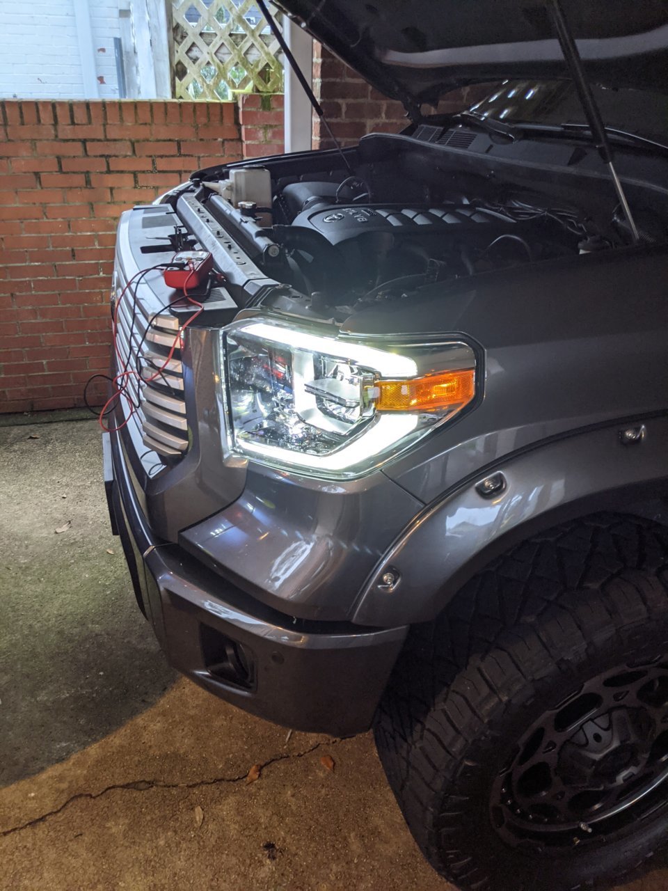

    Thanks for following up via this thread and email as well. Below is an update on troubleshooting.
    • I removed and cleaned the 7.5 amp DRL fuse. There didnt seem to be any issues with it.
    • I put a multi-meter on my battery without starting the truck. It read 12.15V. I started the truck and let it idle for 30 minutes taking reading every few minutes. The battery voltage jumped up to 13.86V and then slowly went down to 13.25V after 25 minutes at idle.
    • The DRLs seemed to work fine the entire time the truck was running. I cycled them on and off maybe a dozen times and could not reproduce yesterday's issues.
    • I did however notice that the DRLs did not dim to 50% when the headlights turned on. They stayed at the brightest level regardless of what the headlights were doing. See picture below.

    I think there's a setting in Entune to change the DRL dimming (I don't have my stock HU anymore so couldn't tell you where to find that) so maybe check to see if that is set one way or another.

    Without the engine running, a fully charged 12V battery is 12.6V. Your battery is undercharged. I am surprised the truck is starting. I would keep an eye on it.
    Since your truck came equipped with LED DRL, it will have a LED DRL relay. It is located in the junction box under the hood on the driver side. If the flickering activity was synchronized on both headlights, and now the DRL stay at 100% brightness all the time, I would suspect the LED DRL relay has gone bad.
