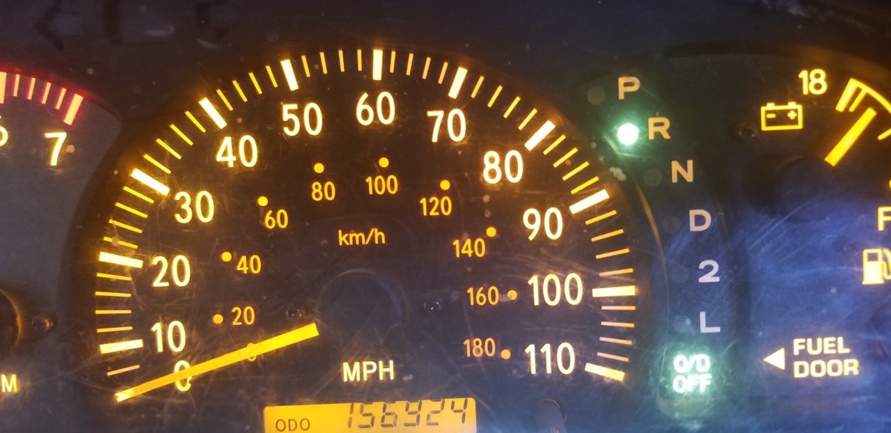

    Up to you. I went all amber LEDs on my gauge cluster and HVAC, just because that's my personal preference and it's easy on the eyes. Some of my dome lights are LED white and I don't care for them. I still have my OEM condom bulbs if I ever want to use them.

    So I have white LEDs in the Corolla which I don't like, that's why I went straight to amber. The ambers come in handy for me on longer night drives. Turning the brightness down makes it even more comfortable IMO.
    I don't have very many pictures of the cluster, but you kind of get the gist of it. It's nice getting rid of the green condoms.
