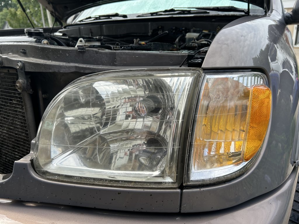

    Drop in bulbs generally suck. Look for a “mini-projector” in your bulb size. Fits through the existing bulb hole, features a mini-projector LED lens that’s forward facing and a secondary LED chip to fill the housing reflector without scattering too much light outside of the normal lighting field.

    Have some in my 2000. They are great.
