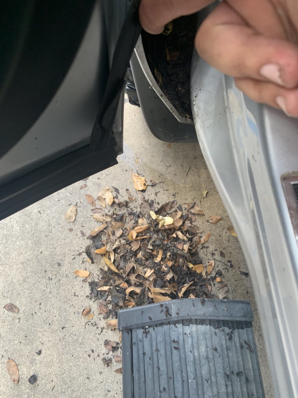

    i was cleaning my tundra today and noticed a leaf coming out behind this rubber by the door hinge. There was a crazy amount of dirt and leaves in there. How did they even get in there? Anyone else experience this?

    @Steve Tundra, :yes: All the leaves and everything else gets in from top side. Notice when you have the hood open right there by the spring for hood. I clean mine out once a month. Have you checked you cabin air filter lately? That gets dirty as hell too.:eek2:

    Found same in mine just drivers side.Home depot Lowes both have one sided adhesive backed 2" rubber strip that comes in a big role.I closed off that big whole at hood hinge.The rubber has soft give so it will dothe job until someone comes up with better solution.

    That grille behind your hood is the located in a low pressure area at the base of the windshield to provide fresh air to cabin HVAC systems. If you park under trees, you are very likely to accumulate leaves, twigs, and other debris in the plenum. The dirt is a little strange unless ants are carrying it in for a nest.
    The holes are there at the fenders SPECIFICALLY for allowing debris to wash out of the plenum. I wouldn't stop those holes up with anything. Make sure the fender is draining free, and when you wash the truck, hose out that area and the fender. Leaves and debris left in there will stay wet from rain and car washes, and can rust out the lower fender.

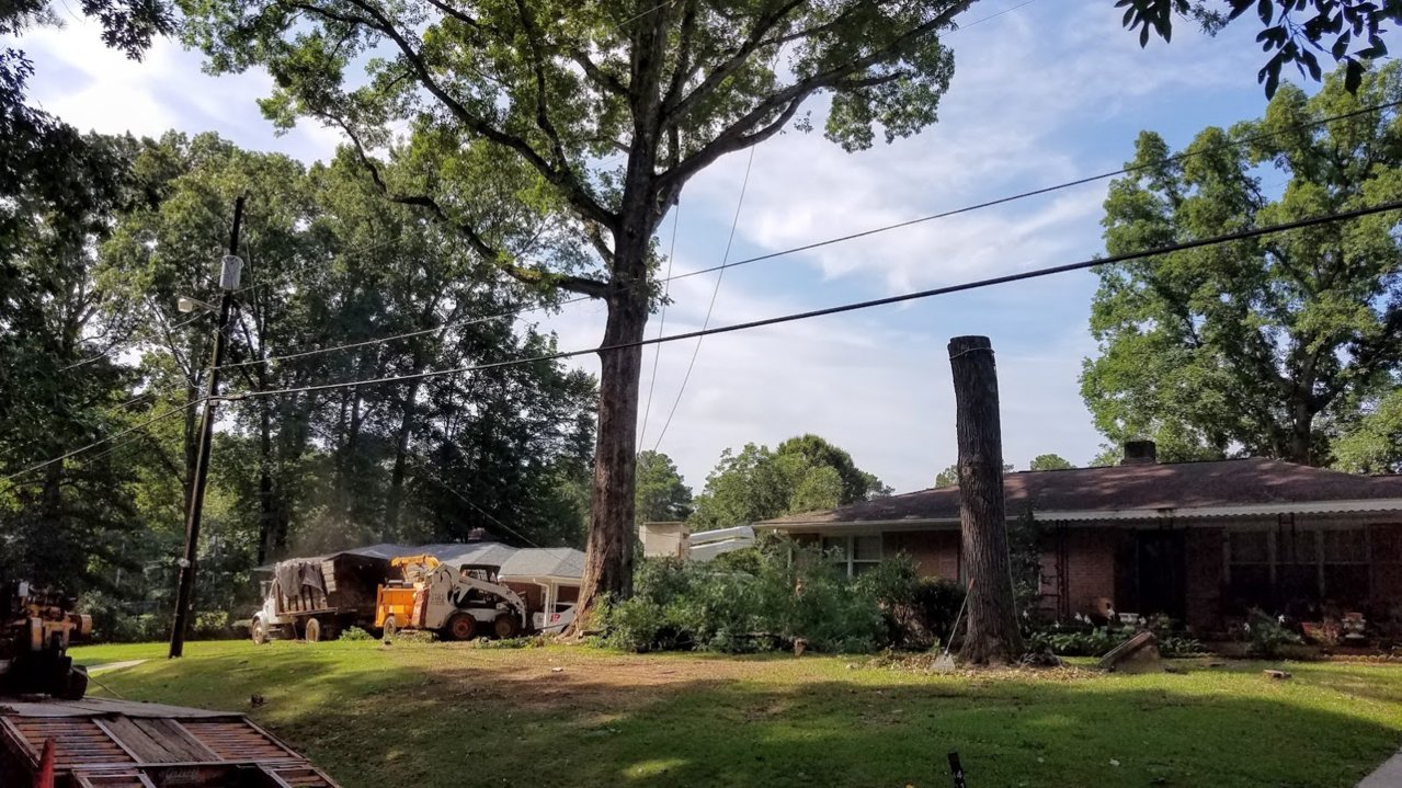

    This is what i'm doing to take care of the problem.
    l3zOy7RdZ0aWCyFEm9kck0niDcyHQesgXMz99l-S_c36a6e33a601bb849c762747b82146e2b9f64d27.jpg
    Overkill?

    Not at all, if it's an option. I have WAY too many oak trees around my house for that to be an option. I also don't have liners in my front wheel wells so debris and leaves can't accumulate. If they could, I'd spend most of my fall cleaning out my fenders! :crapstorm:

    The roots are dying on those trees so it's take them down now or wake up with them in our bedroom one night. I won't miss the leaves but it's gonna be a pain getting the yard rebuilt.
