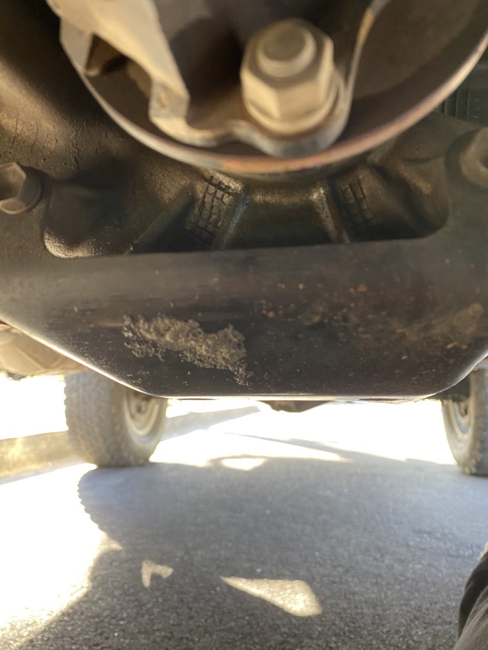

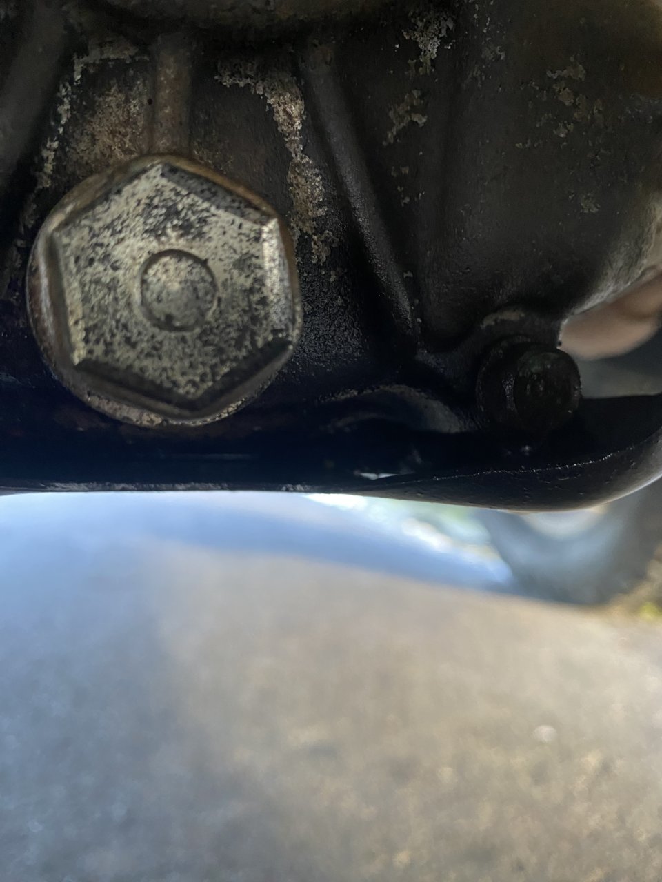

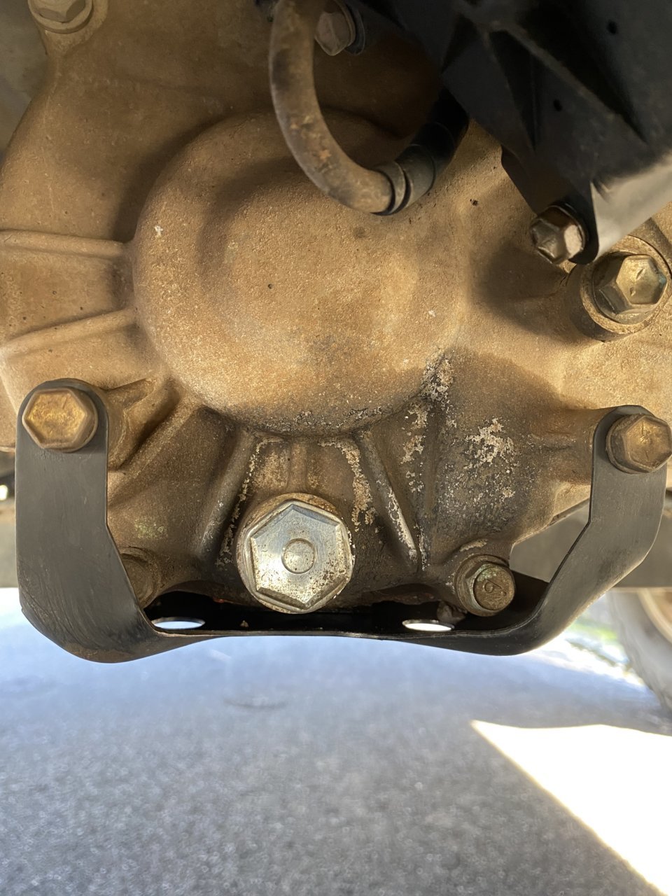

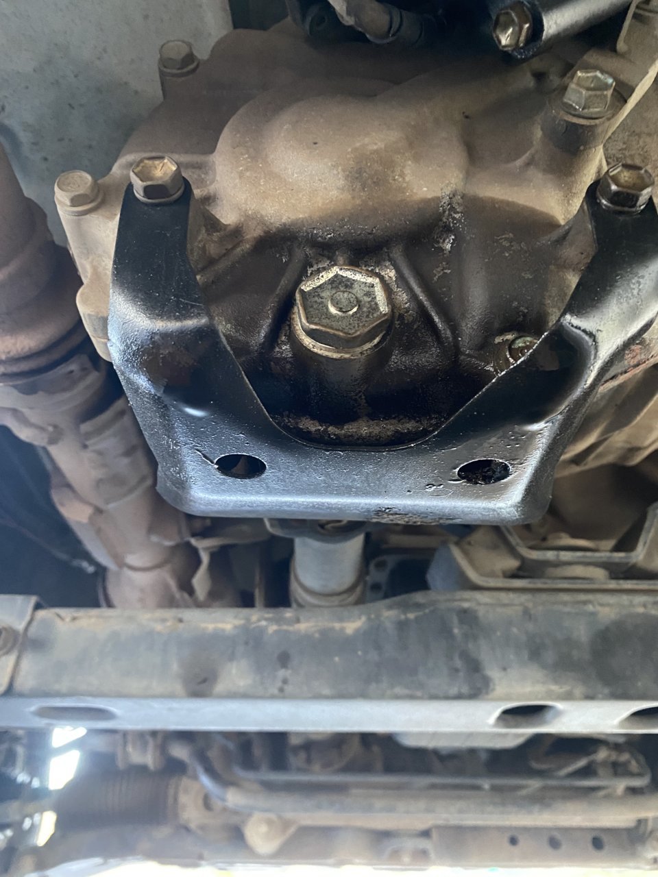

    I noticed a slight leak coming from my transfer case after returning from a road trip of about 1500 miles with around 60 miles in 4WD doing some offroading/camping. Is there any way to identify exactly what the issue is and if I can fix it myself, or if I will have to have something done by a shop? I've attached some pics to the thread, but taking clear pictures underneath the truck is always a bit of a challenge.

    Does look leaky around the drain bolt. Can't see the fill bolt in those pics. Did you check the breather for the diff? If it's plugged up, pressure will build inside the diff when it warms up and fluid will find a way to force itself out of whatever crevice it can find. Axle seals, fill and drain bolts etc.

    I agree that it does look like it's coming from the drain plug -- which would be super easy to fix if that's the case. Can you take a pic from the front of the transfer case? That would tell you if it's coming from a front seal and migrating back as you drive.

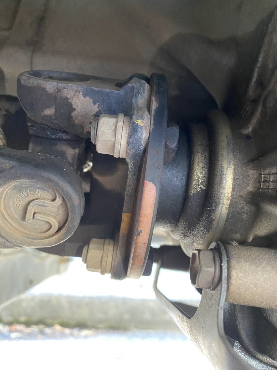

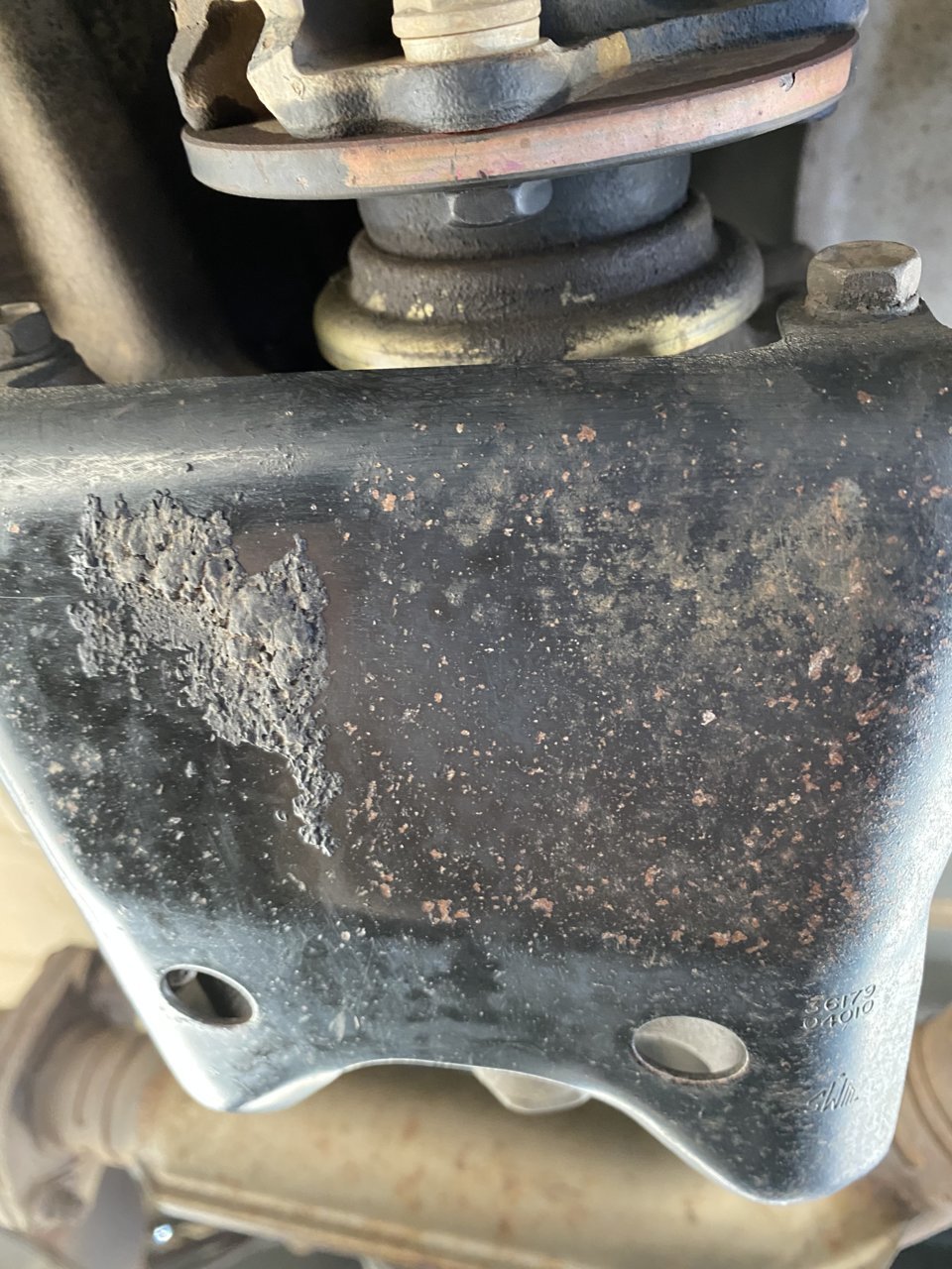

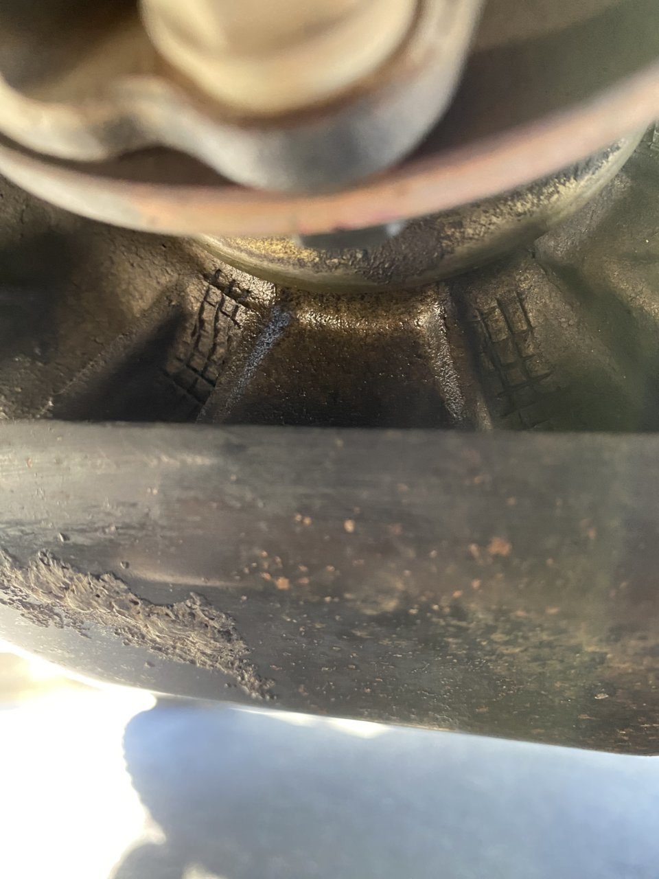

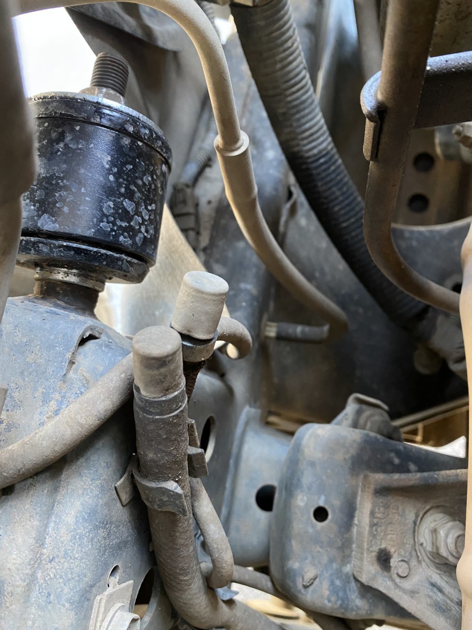

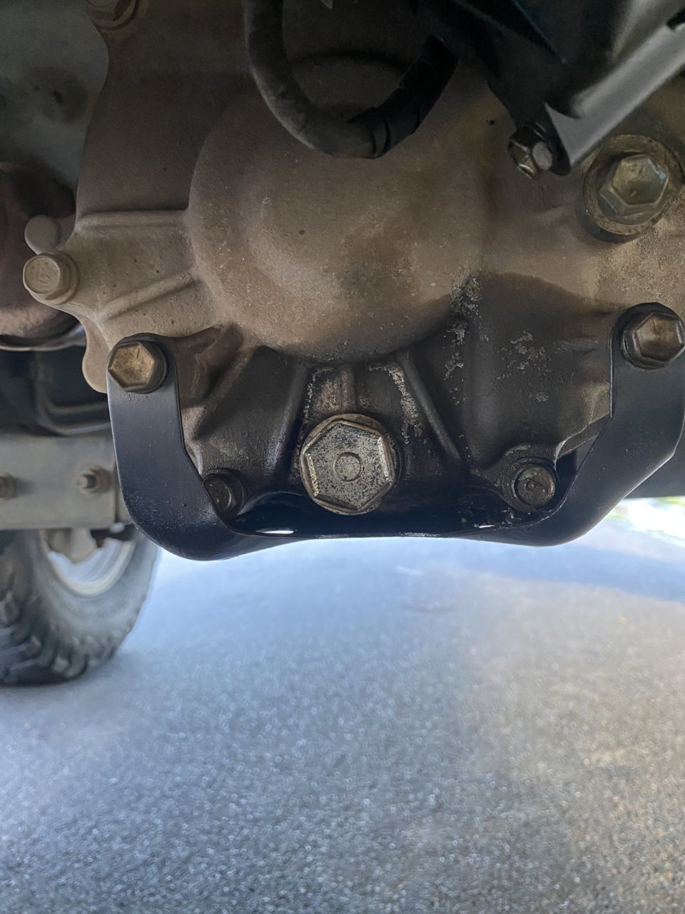

    Here are some more pictures. I washed the truck today, both the body and underneath. Paid special attention to the transfer case and scrubbed it up to see if it leaks some more and then I can pinpoint where it is coming from. I also double-checked both the breathers for my front diff and transfer case. Both of them look to be okay.

    So it looks like it's leaking from the front output shaft seal. I had this go out on mine, and it seems to me semi-common in these trucks and 1st gen tacos/ 3rd gen 4runners. Not a terribly difficult job to replace, you do need to drop the front drive shaft. I recommend this Timmy the Toolman video:

    That sure looks like it's leaking from the front seal.

    For years i always wondered what those two dead end hoses were and now I know. Thanks.
