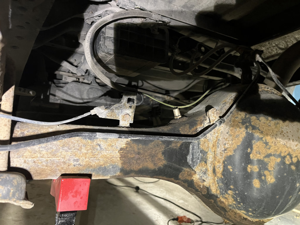

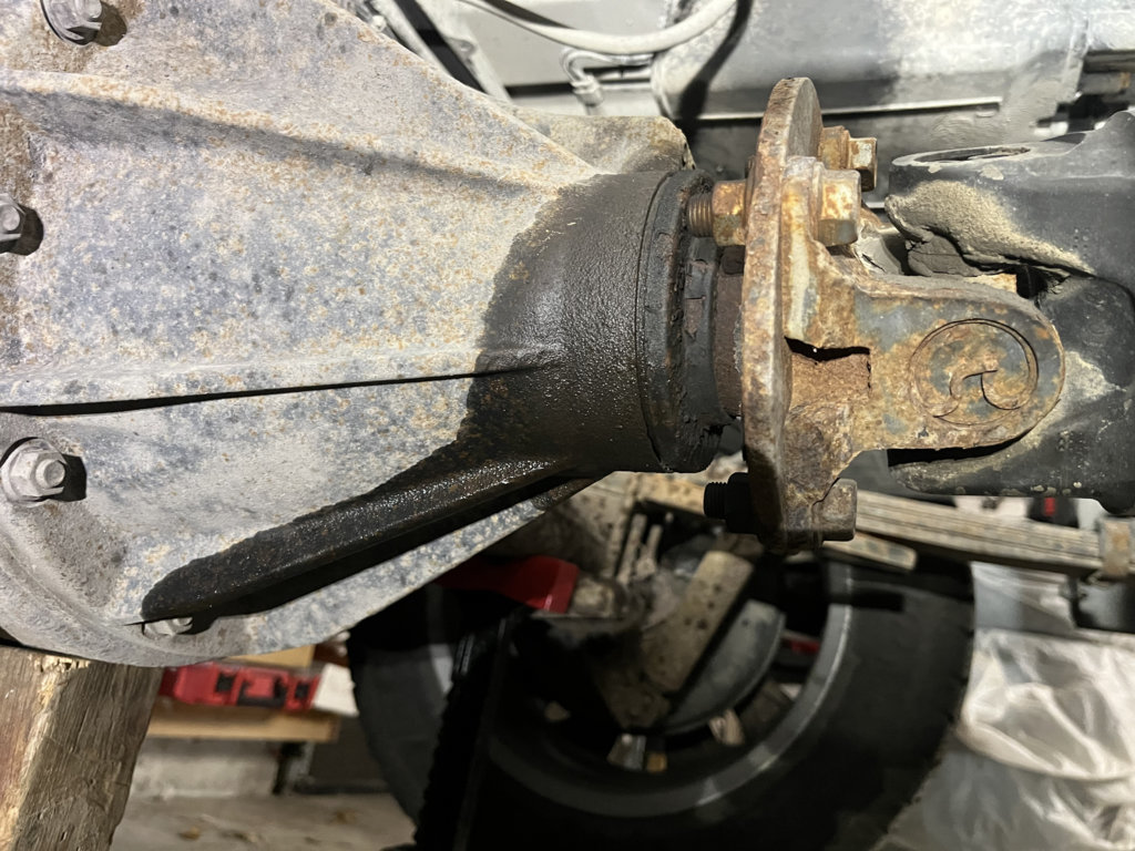

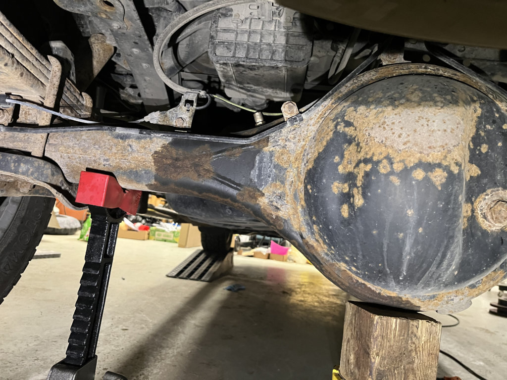

    2013 Toyota Tundra Platinum with 135,000miles.
    Recently, I noticed a humming/howling noise starting at about 40mph and continuing to 50mph. Then the humming noise decreases or stops at 50+mph. There is NO noticeable vibration, or drivability issues, just a humming/howling noise.
    I got under the vehicle and it looks like oil is leaking from the differential where it meets the driveshaft. I also noticed oil leaking from the vent hole at the top.
    Maybe heat from a bad bearing causing it to leak from the vent hole?
    Anyone have a similar issue? Any idea what this may be?
    Thanks in advance! Curt

    Did you push vertically right at the pinion flange? Did you check backlash as well? Backlash
    can be ok just by rattling it back and forth but there better not be any vertical knock, rattle or movement
    at all.

    Just checked it, everything feel tight. No movement vertically or horizontally at the differential driveshaft junction. Guess the next step is to take a look at the diff fluid. I'll drain a few ounces and see what it looks like.

    Drain it all. Need to look at the magnet on the plug.
    Doesn’t mean the bearing is not shot it’s just not really bad. Could be the pinion seal
    only is shot which isn’t too bad. Next step is put rear axle on stands and remove
    driveshaft. Then remove wheels. Turn the pinion by hand. Now there is no load,
    if the bearing is really bad you might feel it as it turns. I just pulled rear diff of my
    Land Cruiser apart. I could almost feel it grate. It was shot but still went around.
    The race was ground up by inner bearings. One step at a time.
