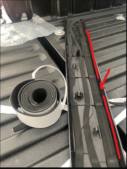

    It is much better after redoing it again, here is my review after a year:
    when you apply silicone sealant run over it again to create 2-3 mm paste. that will help eliminating uneven surface when you apply pressure specially after installing the bed cover. if you don't feel comfortable applying paste you can use weather stripping seal liker this (I used both sealant and weather stripping):
    https://www.amazon.com/gp/product/B07471S61T?ie=UTF8&th=1
    Cut the weather stripping into half (width less than an inch) and run it underneath the bed rail. worked great for me. The next step is to sand the upper part, when it rains hard or I drive on the highway there is a leak from around the uneven surface. please see attached picture.
    I'll do it this coming spring while installing CBI bumper/winch/light bar.
    Good luck

    I'm also contemplating sanding down the pattern on the caps as well. Honestly might be necessary since the weather stripping on the DB cover doesn't contour very well.
    @Oakman - do you happen to have any pictures of the underside of the plastic bedrail caps? Also, how did you remove them? When I tried to do it, it felt like I was going to break the clips holding them onto the bed.

    Removing them was easy, just do not put more power or over angle them when you are pulling up, start from the bed gate, they are easy to break,
    Attached some pictures during the second round after scraping and reapplying the silicon underneath, these pictures for the weather stripping part
    upload_2024-2-15_16-12-57.jpgupload_2024-2-15_16-12-57.jpgupload_2024-2-15_16-12-57.jpg

    This weatherstripping you’re putting down is foam. It’s not a sealant. Looks like it’s adhesive backed on both sides correct?

    The raised edges might also create little gaps where water can leak through.
    I wonder if you can actually add weather stripping on the inner wall of the cap towards the inside of the bed so that it traps any water from dripping down.

    I spread silicone sealant on the metal part underneath the bed rail cover and on the plastic part the weatherstripping. it is adhesive on one side,

    That's a good idea, I haven't tried it. So far no issues underneath the bedrail cover

    If you’re looking to totally stop water you’ll need something that’s more of a gasket. I don’t know how deep you wanna go with trying to stop water. But there are better options
