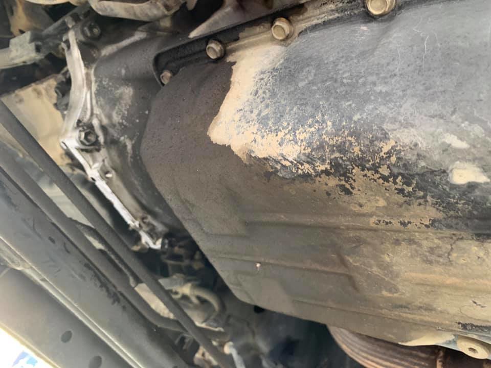

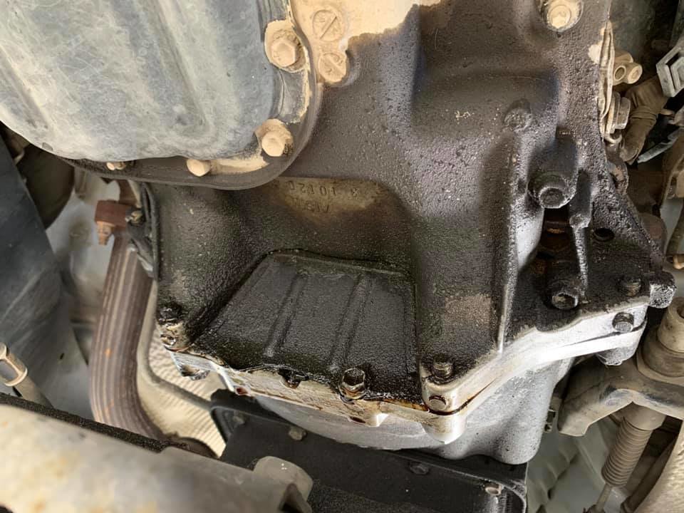

    I'm losing engine oil. I'm sure it's engine oil because when I noticed the leak, the oil was dirty and it's now clean after an oil change. Usually just a few drops each time I park it but enough that it will make a big mess in the driveway over time.
    2005 Double Cab 2WD with 81k miles
    5w30 Mobil One oil
    I'm guessing it's the rear main seal but would appreciate some input based on these pics. Should I replace the upper oil pan gasket first? I know it's really tough to do on the 4WD trucks but what about 2WD?
    Thanks,
    Bob

    It's good
    Edit: Pics now showing, I was wrong, they tell a lot. Btw, cant be the oil pan seal.

    likely rear main based off that photo. but a really bad valve cover leak could technically come down the trans and pool there too.
    but likely rear main

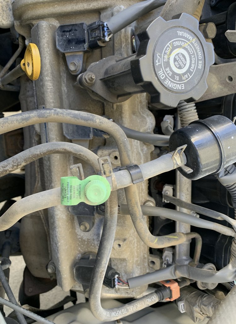

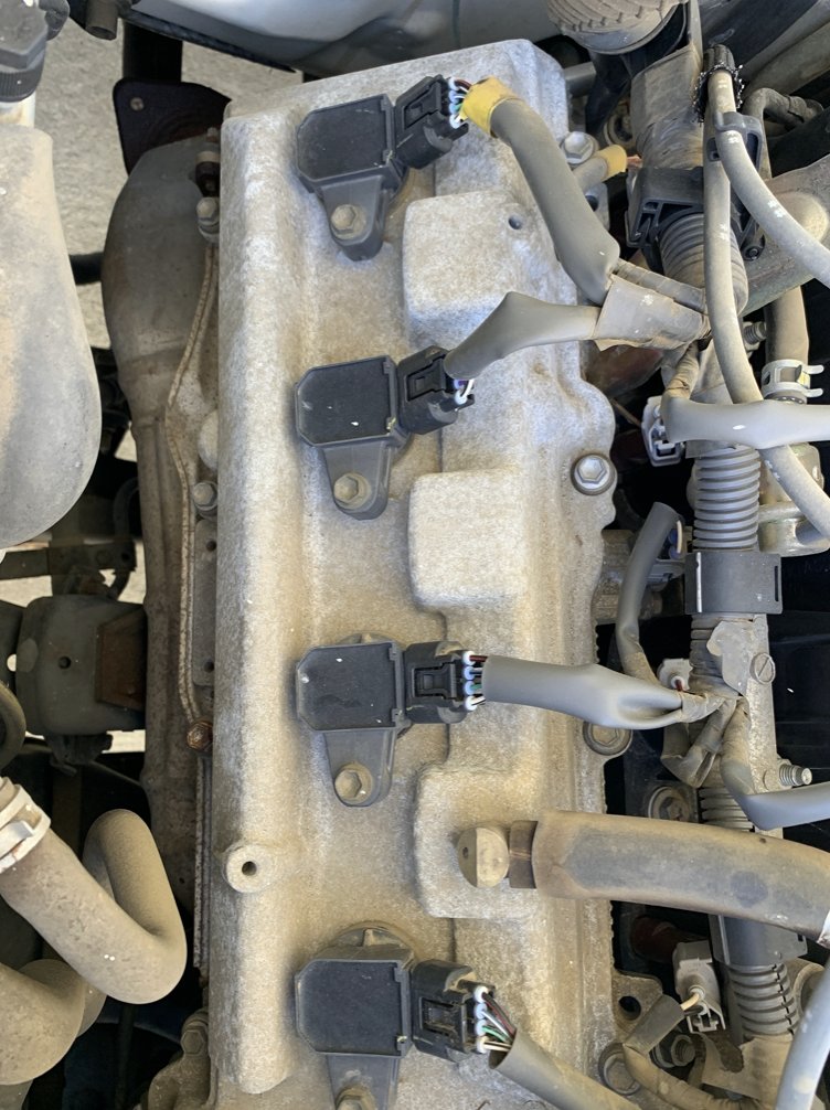

    Valve covers are dirty but look dry from top and underneath.

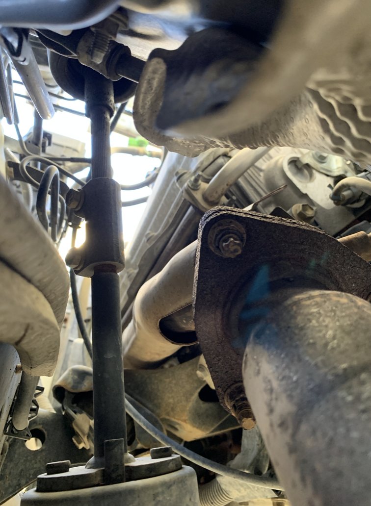

    Got under the truck today with my oxyacetylene torch and busted loose the 4 bolts holding the exhaust together behind the cats. Re-assembled with copper anti-seize. I'm not sure if I'll drop the exhaust, but I want the option and I want it to come apart easily when it is time. Truck came from salty air SF, so the bolts were treated with Loctite "rust". :D

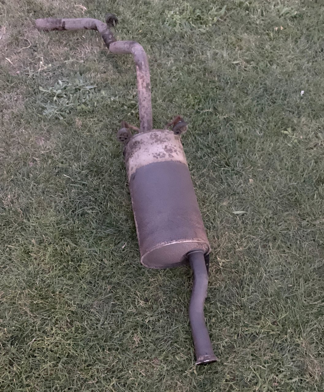

    Next step: remove the muffler. I won't have parts until next week so the truck will be a little on the loud side until then, but that's ok. Going to remove the surface rust and paint it. It actually sounds really good without it but the drone is pretty bad.
    Leaving it in the front yard as a "lawn decoration". We'll see how long it takes wifey to notice.
