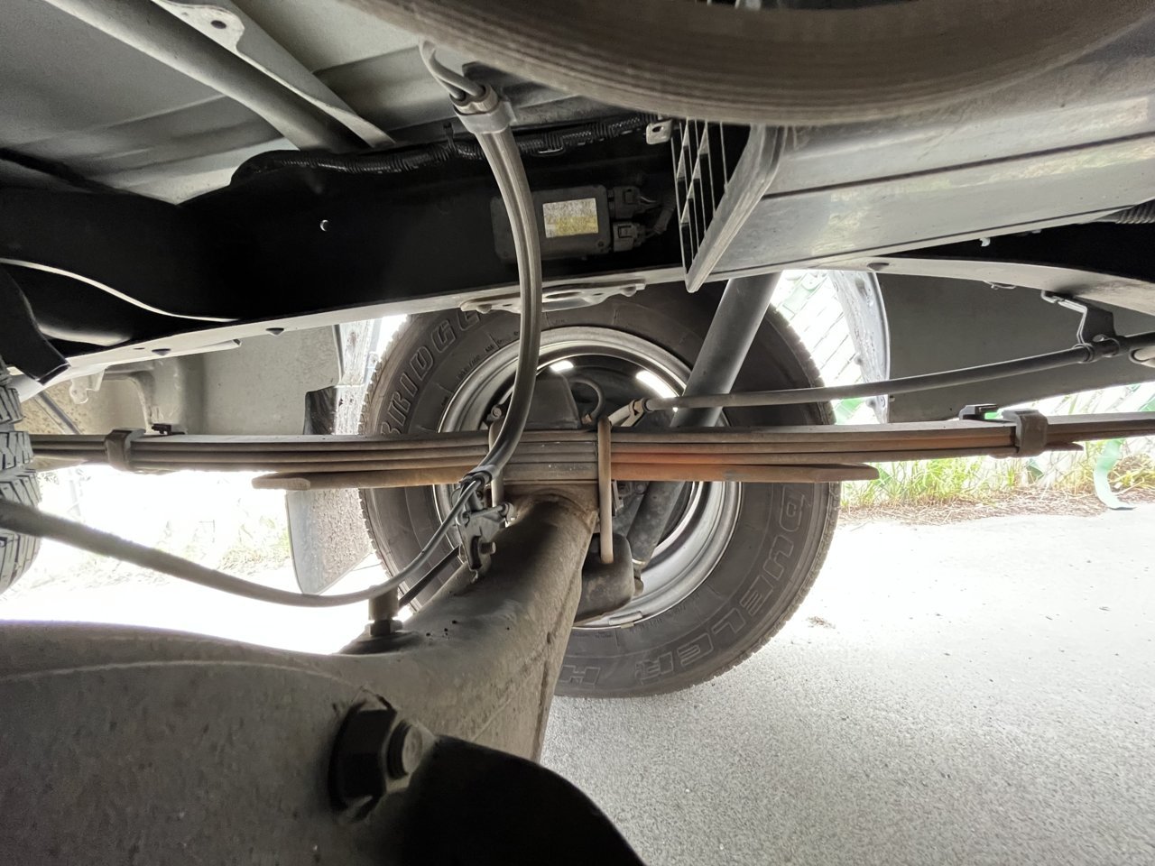

    The other day I noticed that my leaf springs look more like a “W” than a nice arch. Pretty much everyone on the forums says they’re toast. After burning out my brain spending a couple of hours researching leaf springs, including the forums, does anyone have any suggestions for good quality leaf springs that won’t break the bank? I want to keep as close as possible to stock ride height, but a little lift is okay too (no more than 2”). I would also like better performance under load and longer life than the piece of crap stock springs. My truck only has 80k miles, so seeing flat springs is honestly kind of shocking.

    I’ve read good things about Alcans. I’ll check them out. These are my driver side springs. There is almost no arch at all. There is no way this is normal.

    If you look under Tundras that you see in parking lots you will see that this is quite common.

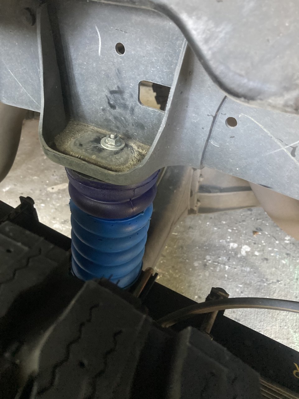

    I’m a big fan of sumo springs in this situation. The OEM springs and alot of aftermarket springs will eventually sag with or without a static load (but way faster with a static load/filling to capacity). The sumo springs just barely make contact with the OEM springs when unloaded and help prevent sagging. Recently I put in Dobinsons leaf springs with a 2” lift then added another 2” of sumo springs to also have constant support for loads. Install is quick and they have no maintenance whereas air bags are superior in ride/control but have more maintenance/setup (just tradeoffs).

    Oh for sure, the most common setup is part number SSR-610-40 and are usually 250-300$. Those are 1000lbs (blue) at half compression so are the softest, then there is a 1500lb (black) version and even more like 3000lb (yellow). Alot of people will say don’t reuse your leaf shackles as they stretch when torqued the first time (so consider getting new shackles if that is a concern). These will make the truck ride more stiff when unloaded, as there is much more support (somewhat like a sway bar when turning too). I’ve had these on two tundras for 100k miles and like it that way haha.

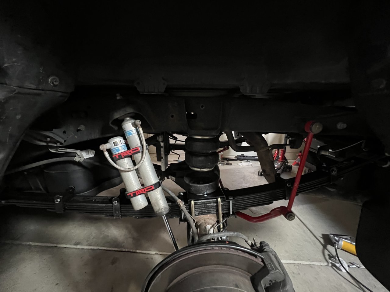

  18. Jun 16, 2023 at 3:17 AM
    Krewcial
    Krewcial So good with my rod, I make fish come!
    Jan 21, 2017
    #6041
    110
    Don
    2010 DC (3UR-FE) & 2000 AC (2UZ-FE)
    -Kings 2.5’s shocks -JBA UCA -Wheelers front bumpstops -Torque air bags with Daystar air bag cradles -Alcans leaf’s +700 lbs 1” lift -Dobinson grease-able shackles -TRD front and rear sway bars -RCI Engine, Transmission/Transfer Case skid plate -RCI Catalytic Guard -RCI sliders -Magnum ICI RT series bumpers -Auxbeam 72W Amber 4" round spot off road lights -Morimoto XB LED headlights -Level 8 MK6 +12 offset 18" rims wrapped with 285/75/18R Falken AT3’s with TRD centercaps -TRD dual exhaust with black chrome tips -AFE Power Magnum FLOW Pro DRY S Air Filter -TRD air accelerator -WeatherTech floor mats -Aftermarket Sequoia Grill -MAX Modular bed rack with tonneau brackets -Diamondback HD tonneau -James Baroud Grand Raid XXL -OVS 270 awning -11” Alpine iLX-F511 media receiver
    I went with Alcans, airbags, cradles and dobinson greaseable shackles. I even reached out to @Tundra234 before hand on the ride quality.
    I’ve only had everything installed for 2 weeks but took a dirt road at about 55 mph after install and boy did these leaf’s perform. Also yesterday there was a good stretch of concrete highway that’s known to cause the infamous bed bounce. I could see the bed wanting to start bouncing but the rear end held up and rode smooth.
    Overall I’m extremely happy with the ride quality and so far no squeaks or noise coming from my rear end.
