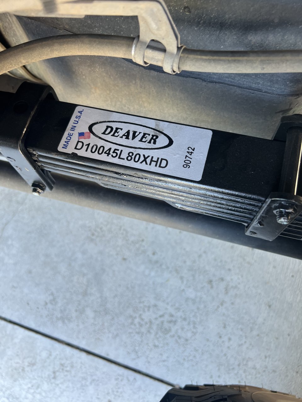

    We just switched from Alcans to deaver on the old man’s rig. You’ll need a custom pack. we recommend deaver they hold up more and are much better quality. The ride is much better and more progressive.He’s got a good amount of weight. GFC camper, steel bumper with swing out and 37 along with a deck system.

    I had both and the Deavers are night and day better. The Alcans went flat in 6mo compared to the Deavers that were going steering a year later.
