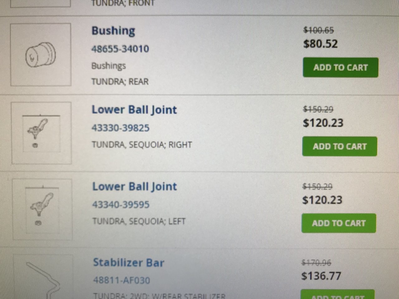

    Edit: Toyota LBJ recall kit is part number
    04006-62134. Check with your parts dealer first to confirm for your year/model.
    Yes, I searched, but I’ve read there’s better OEM LBJ’s on a few posts so it’s making me second guess whether I’m getting the right parts. So...
    Ordering the parts to do my LBJ’s, can anyone confirm if I have the correct part numbers and if I need any additional parts since I’ll be down there? Also, is $120.23 each a good price?
    43330-39825 (Right)
    43340-39595 (Left)
    Thanks in advance.

    From everything I’ve read, and anyone can feel free to correct me, that OEM recall kit is the best option. Definitely try to avoid aftermarket LBJ’s. UBJ’s are a little different from what I understand, but I’d stick with OEM unless upgrading to entirely new UCA’s.

    Yes. It's a strong belief here that only OEM LBJ's should be used. Many aftermarket units fail after few miles. Can be mucho dangerous too.

    So I'm guessing these are the same parts, just that the 04006-62134 comes as a kit (1 pair)?

    That's my understanding. I messaged Roman with Cool Springs Toyota to confirm, I'll write back on here once I hear from him.

    Yes, it's both. Sorry, I misunderstood. I was confirming that the part number was correct for my '06 DC. Roman wrote back and confirmed so you should be good to go.
    Yes sir, it's both. That kit is the way to go from all the research I've been doing.
