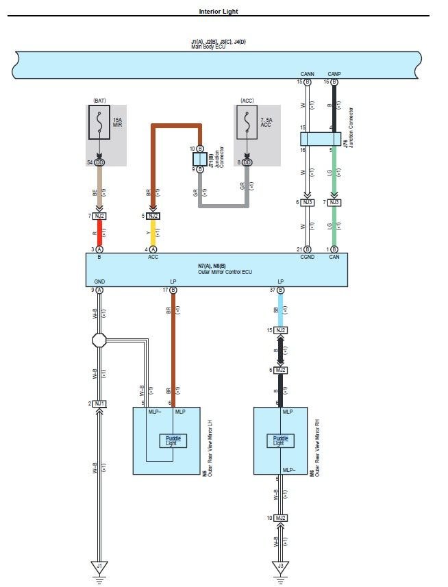

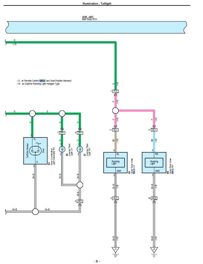

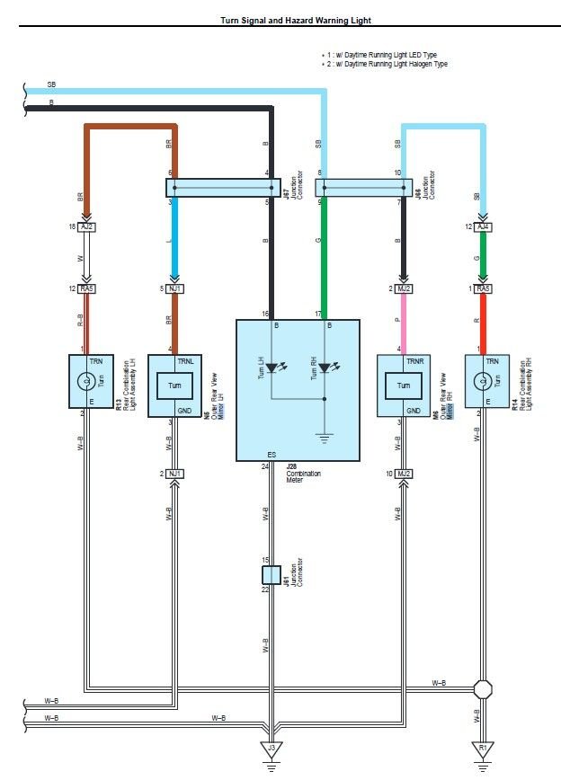

    Hello. Downsized from Ram 2500 4WD HD / Cummings. To 21 Tundra SR5 gasser. Yes, I miss that truck. But do not miss the maintenance. Anyhow, so far I have installed on board air, Air bags, ARE camper top, bed mat.
    What I need is tow mirrors. Currently, my mirrors have heat & power adjust only. Wondering what is my truck is factory wired for and can I add things to the mirrors such as BSM etc ?

    Welcome to your first post from Dallas..
    Changing out Non BSM Mirrors to BSM Mirrors.... | Toyota Tundra Forum (tundras.com)
    You might have a parking light, puddle light, and turn signal feed in your truck.
    I ran my own turn signal and puddle lights wiring because my 2014 didn't have either..
    Maybe others will chime in or you can test the mirror plug with a DMM.
    These are 2015 diagrams but they may hep you determine which wire is which in your mirror plugs.
    Turn signal
    Running light
    Puddle lights
    You can find your 2021 diagrams in this thread..
    Ultimate TUNDRA Wiring Diagrams Collection | Toyota Tundra Forum (tundras.com)
