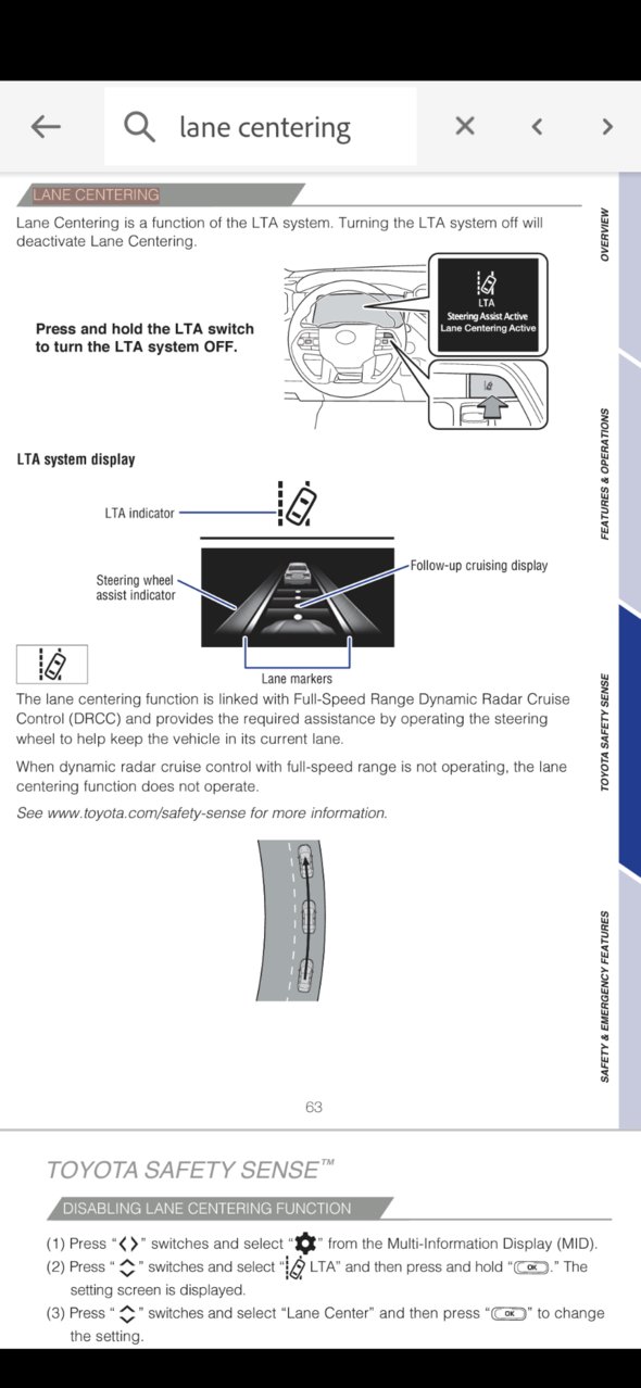

    You have to turn on the "lane centering" function as well. The lane departure only alerts you that you're leaving the lane with an audible tone or vibration. Lane centering actually steers your truck to keep it in the middle.
    Go into the menu on your dash or push the button on your steering wheel if you got it. Page 63 in the manual if you got access to it
