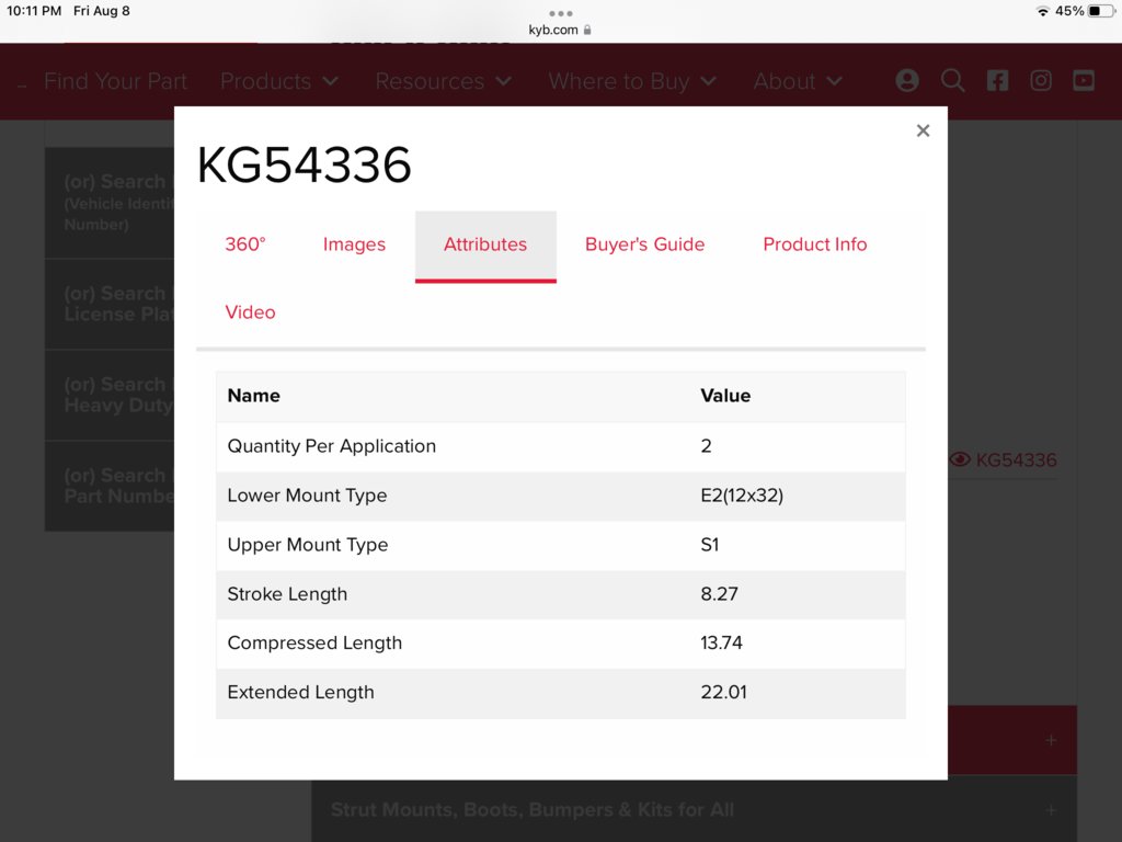

    I found a complete GR-2 kit that shows rear shocks as part# 345066 but trying to buy that number from other vendor says they’re not compatible with my Tundra, not sure who to believe
    Stephen

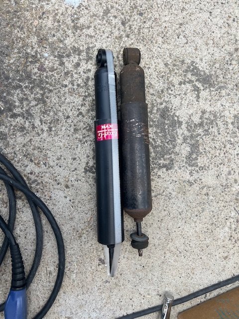

    I did go to their site, no excel GR-2 parts listed for my truck. Will match up the new ones coming in and return them if they don’t fit then buy a set of 345066’s
    Stephen

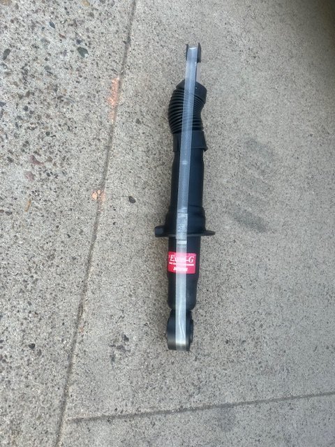

    Thanks, will look into it! I have second gen Tundra KYB Excel GR-2s coming in, will try them and post results here
