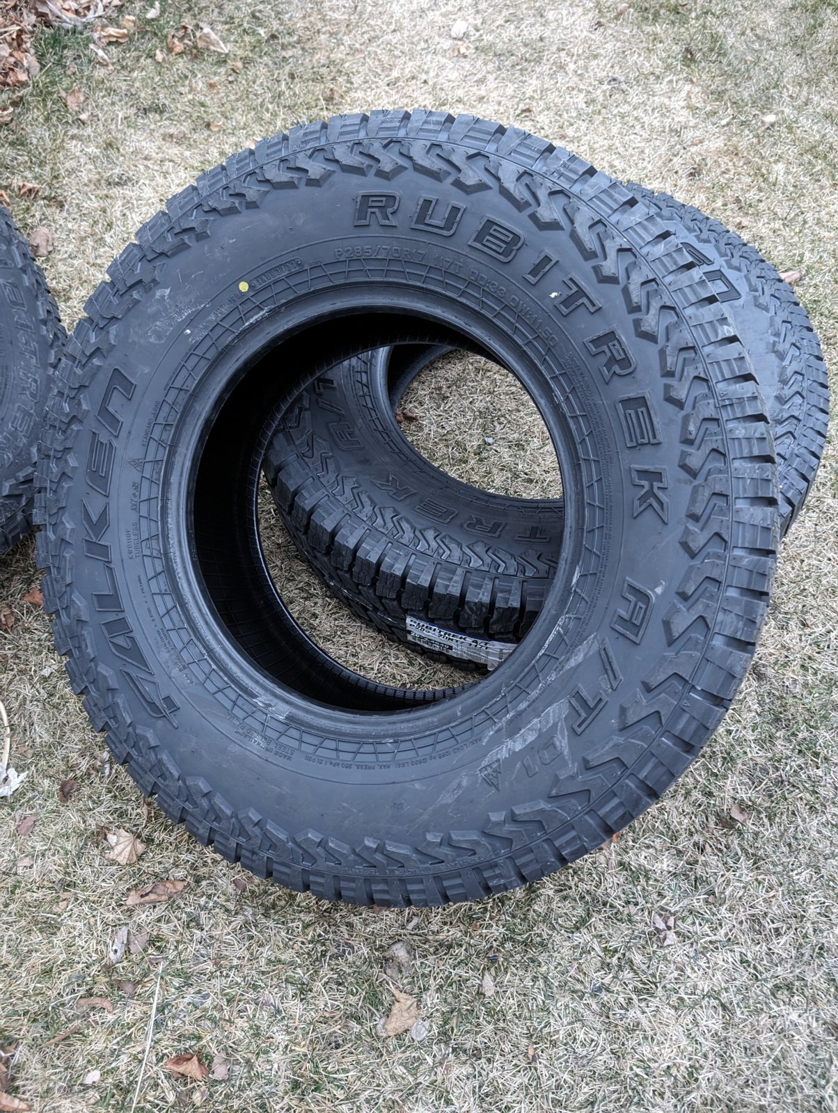

    I've also been experiencing some wheel balance issues after replacing my tires. Not the KO2's though.
    I had a set of Sumitomo Encounter A/T's P285/70R17 (33x11.5) mounted on 17x9 Fuel Beast (D564) +20mm offset wheels for over 4 years with no issues. Rotated every 5K-6K miles and never had them rebalanced. They ran smooth down the highway, but I was ready for a new set of tires.
    After countless research, I decided to go with the Falken Rubitrek A/T's in the same size. I wanted to do business with Discount Tire, but they were unable to order the Rubitrek's. I decided to buy them from SimpleTire and have DT install them anyways. The Falken's started shaking around 65mph shortly after getting them mounted. I brought them back and they told me some of the weights fell off. It seemed to get better, but the shake returned while on a 1k mile road trip. I brought the truck back so they could balance it a 3rd time. They said the balance was off again. They said the road force readings weren't too bad with two of the worst tires around 25 and 35. The balance seems to be better, but still not as smooth as the Sumitomo's.
    I did upgrade to the Bilstein 6112/5100's a couple months before the new tires. I didn't see any loose suspension components and had it aligned just fine from an experienced tech shortly after getting the new tires installed.
    I think my issue could be caused by one or two of the tires being out of round. It could also be a Discount Tire issue. I know there are different adaptors with balancing aftermarket hub centric Tundra wheels compared to OEM lug centric wheels. I also see them going crazy with their pneumatic wire wheel. I might pull the wheels off and give them a good inspection. Hell, it could be our 17" wheels being so close to the caliper and the wheel weights getting knocked off. For whatever reason, it's very frustrating indeed!
