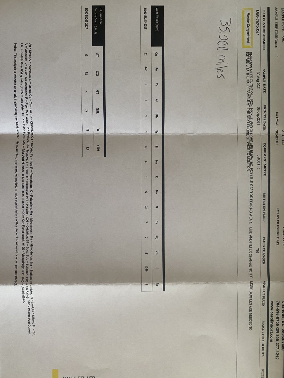

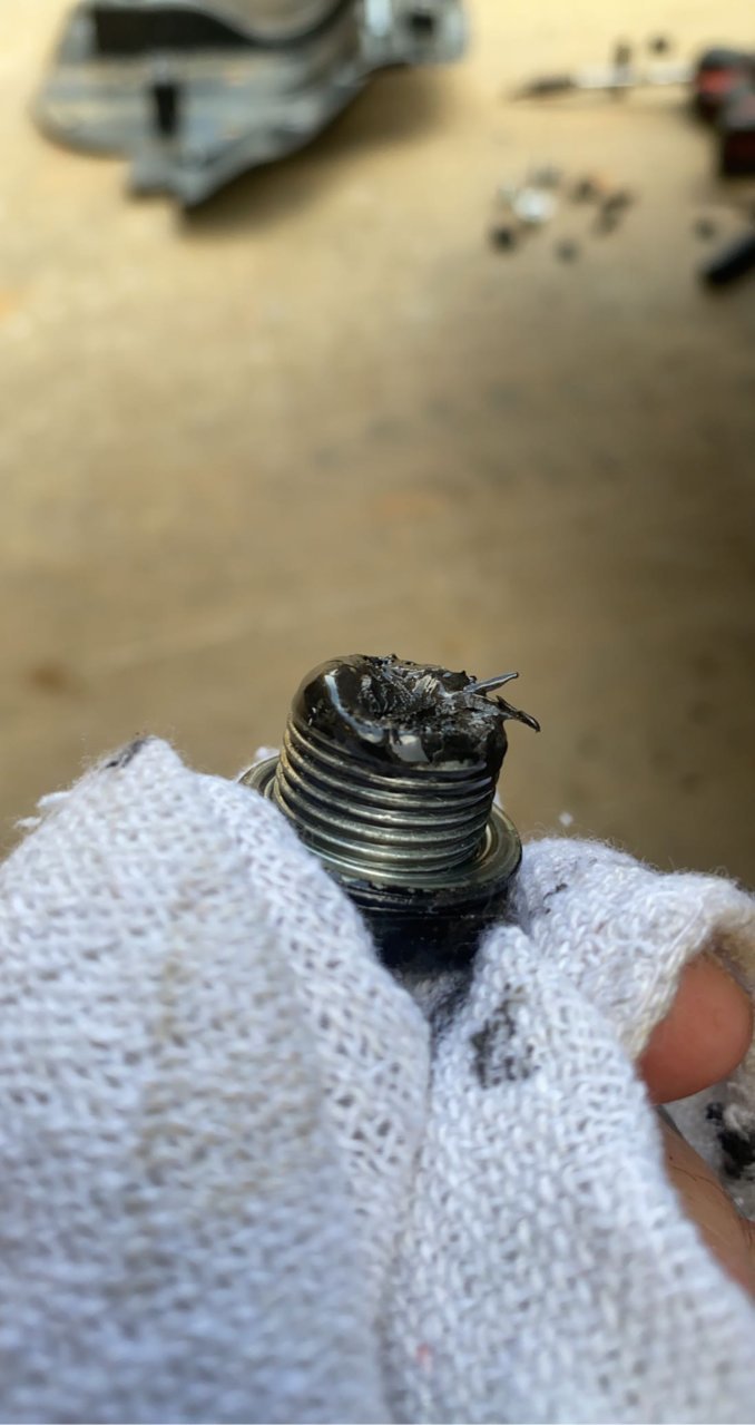

    FFCFC8CB-698B-40C7-904D-DA670F46ED6D.jpg EA5C06C7-8E2E-442E-B85A-971E54A1AB88.jpg Has anyone had any issues related to their axles with 2019 tundra? I sample my engine oil and send it off through my work every oil change and at 35000 i decided to do change all my drivetrain oils to remove any break-in material excluding my transmission because what a surprise… it over heated and it will be going back to the dealer on Monday to be dealt with. All of my samples came back good except for my rear differential. Also when i drained it i noticed a few slivers of metal that no other drain plug had. I work on heavy equipment and in our line of work the drain plug having even a few metal slivers calls for high concern but i have heard from a few auto techs that unless it is heavy metal it’s nothing to worry about. Has anyone else had any bearing or gear damage/premature wear on their rear axles? Should i be worried from what I’ve found or just shrug it off? I’ll definitely be notifying the dealer about it but I’m not sure if i should be worried if they say they aren’t going to do anything about it?

    Just a little update, i picked my truck up from the dealer today and they did not do anything about the trans or rear diff. They said the metal slivers was normal beak in wear and didn’t acknowledge the oil sample. They out the truck on the lift and put it in gear and said they felt no abnormal vibrations, heard nothing abnormal, and had no excessive play. As for the trans they drove it for about an hour and could not get it to over heat or miss a shift or even shift hard. They checked for DTC’s but found none. They didn’t change my oil because they said with no symptoms currently toyota wouldn’t cover the labor or parts to drain and fill the transmission. I don’t think they even popped the plug on the transmission and checked the level to be honest because i checked it shortly after the overheat and it definitely had a burnt stench to it. So they didn’t charge me for any of the diag but they also didn’t do anything to it. So I’ll be doing the trans fluid and filter myself and also will be doing samples on the rear diff and trans every engine oil change so when there is a downhill trend in the samples I’ll be notifying them again.

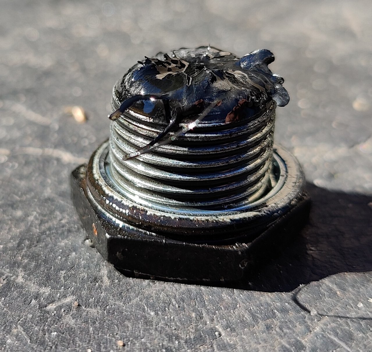

    I'm a big believer in the break-in fluid changes. Did my 2019 rear differential at 4K and also had significant material on the plug and oil was very dirty.. Due to worries also changed at 10K and 25K and fluid and plug were perfect. If this is its first gear oil change then you need not worry. Due another in 10K and it will seem brand new.

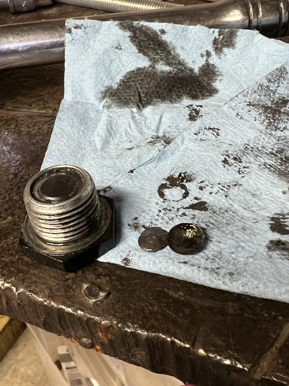

    When I changed mine at 60k miles I found these two metal discs on the magnetic plug. Posted it here and everyone said it was fine. It’s been fine since.
