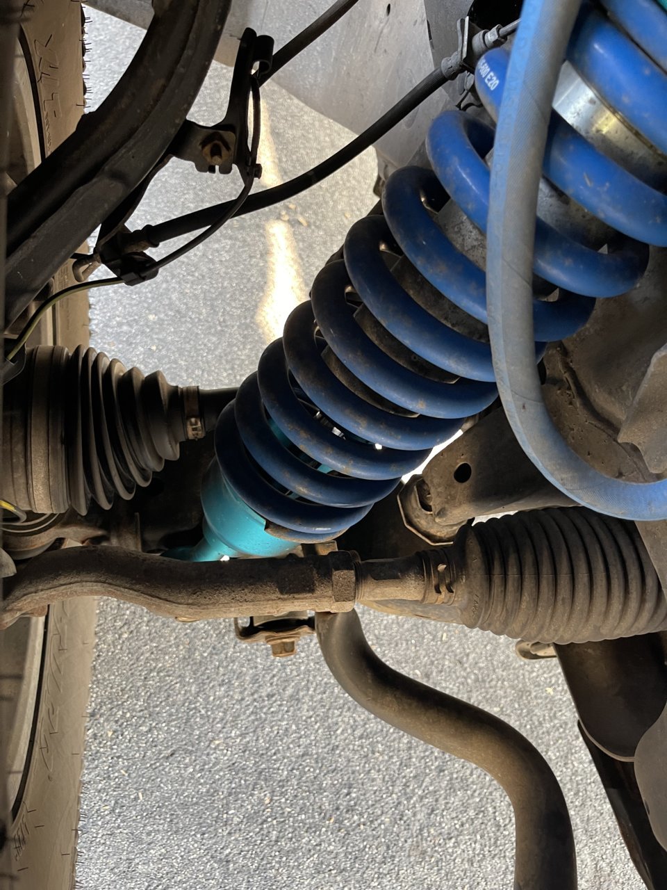

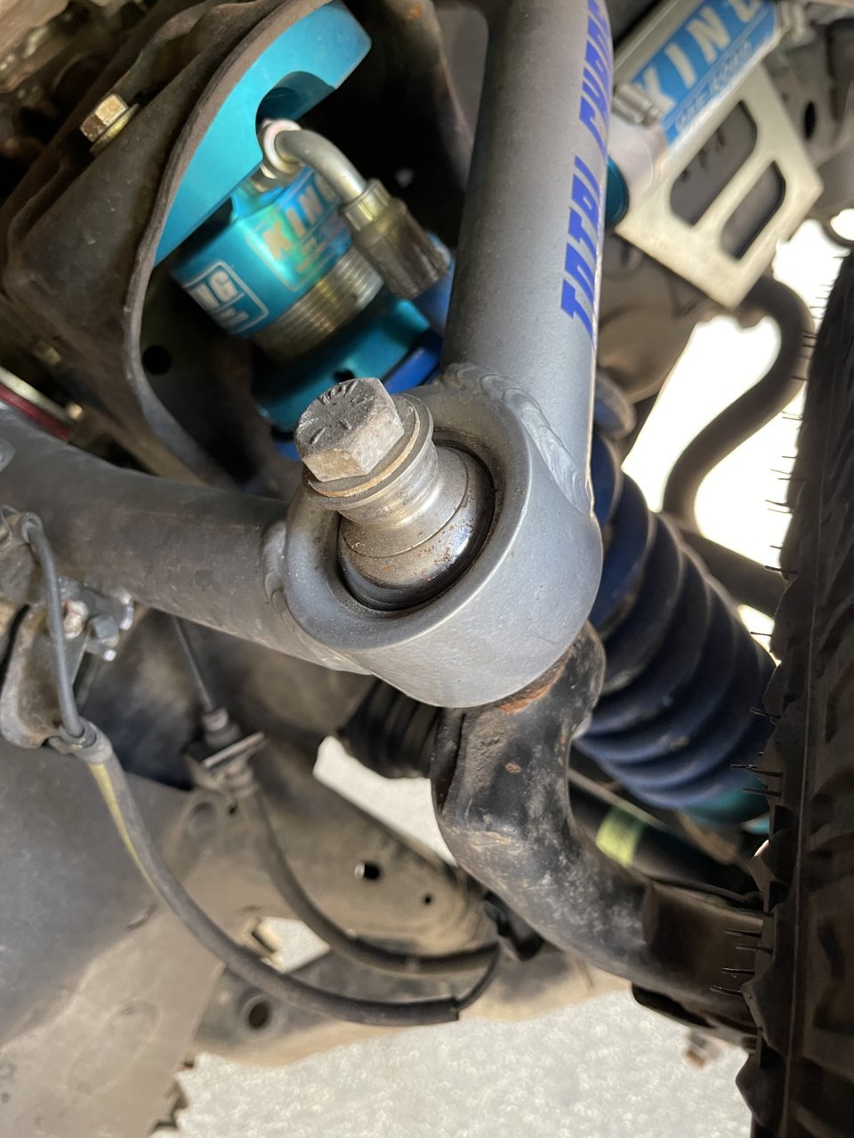

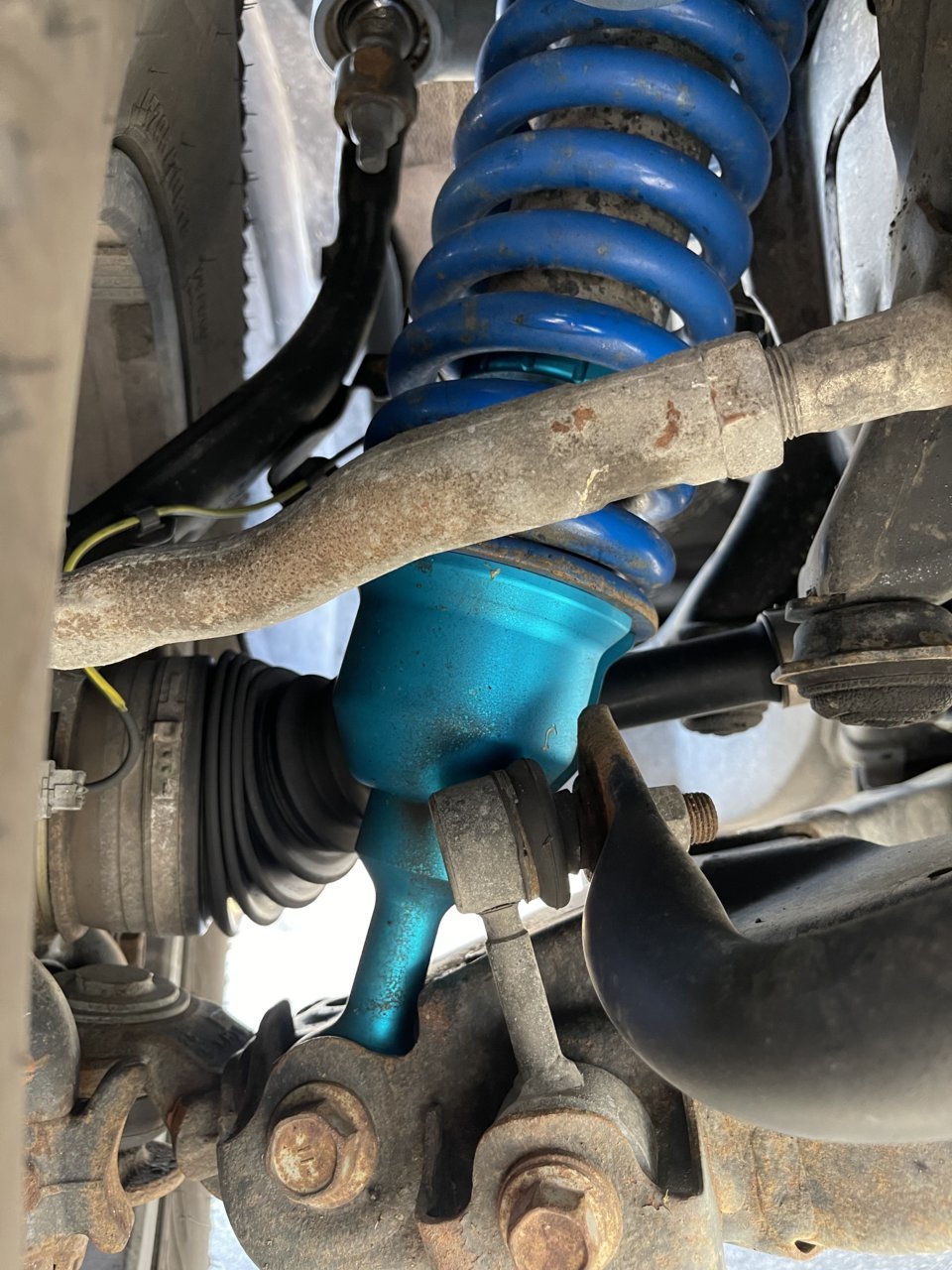

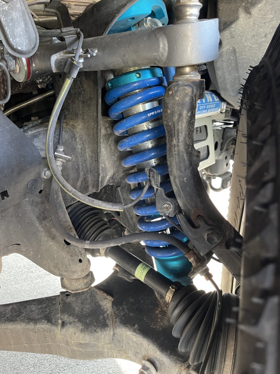

    Took some photos. I want to rig up a go pro and drive around in a parking lot for a bit recreating the sound to see if I can visualize it or pinpoint the sound. Any suggestions for where/how to mount the gopro?
    Any suggestions for what might be happening?
    I’ve taken the truck to two mechanics. The first didn’t notice, and I didn’t ask. The second mechanic said it sounded like something was loose, but he couldn’t find it. I had the truck in for something else so they didn’t really get into specifics on this issue.

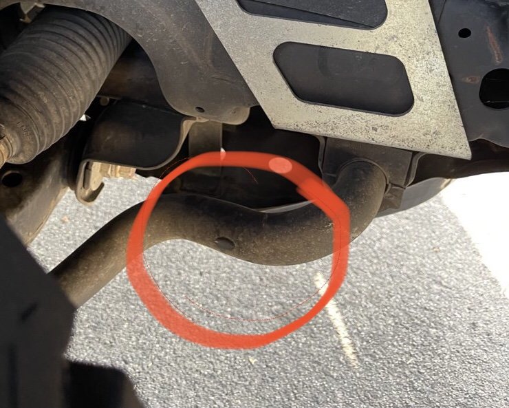

    Does it only happen when turning the wheels one way or does it happen when turning in both directions?
    I did notice that your tire is rubbing on your swaybar:
    SC_TRD, GodlessPro, Wahayes and 2 others like this.

    Wow! Great catch on the tire rub. Anything to be done about that? I'm sure it only happens at very low speeds and doesn't seem to be causing an issue.
    And that's a great diagnosis question... Off the top of my head I *think* it only happens when I'm turning left. I can't recall hearing it when I near full lock on right hand turns. I'll have to do more testing soon.

    If is only happens when turning left then it is likely the tier rubbing on the swaybar. I had this issue as well (I am running 35x12.5s as well). I off-road with my truck so my fix was to remove the swaybar. I have Fox’s with 700# coils so that helps to minimize the body roll on the street.
    Wheel spacers would help get the tires farther away from everything but that would open a bigger can of worms (IMO). If were me I would probably leave it as-is and just not go to full lock.
    edit: What wheels are you running? (A whee with a lower offset may help and would be a much better solution than spacers).

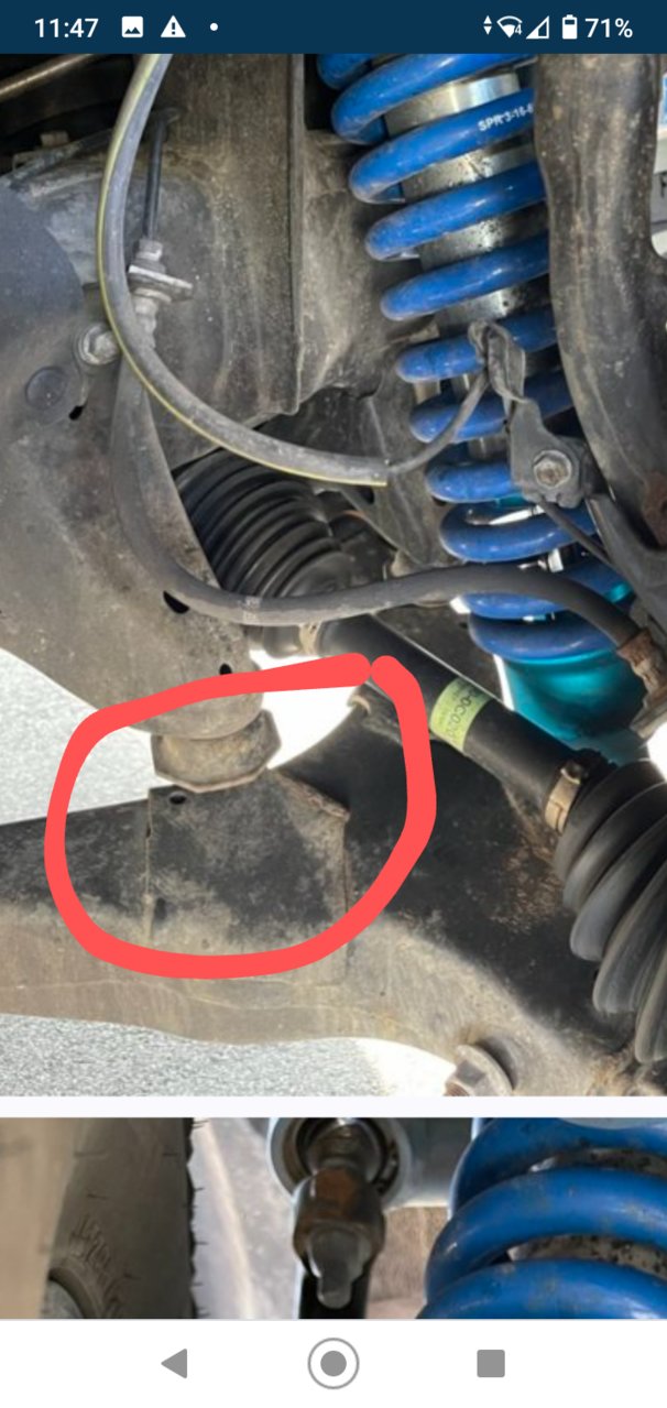

    Some paint is chipping on the spring, so is the tie rod hitting the spring when at full lock. I mean the tie rod is shaped to be closer as it moves inward.
    W3agle[OP] and joseph_womack like this.

    good catch, @W3agle have someone sit in your truck and hold the steering wheel at full lock, while their holding it, stick your head in the wheel well and take a picture or just tell us what you see:
    coil spring hitting the tie rod? Tire hitting the swaybar? Both?
    W3agle[OP] and 2mchfun[QUOTED] like this.

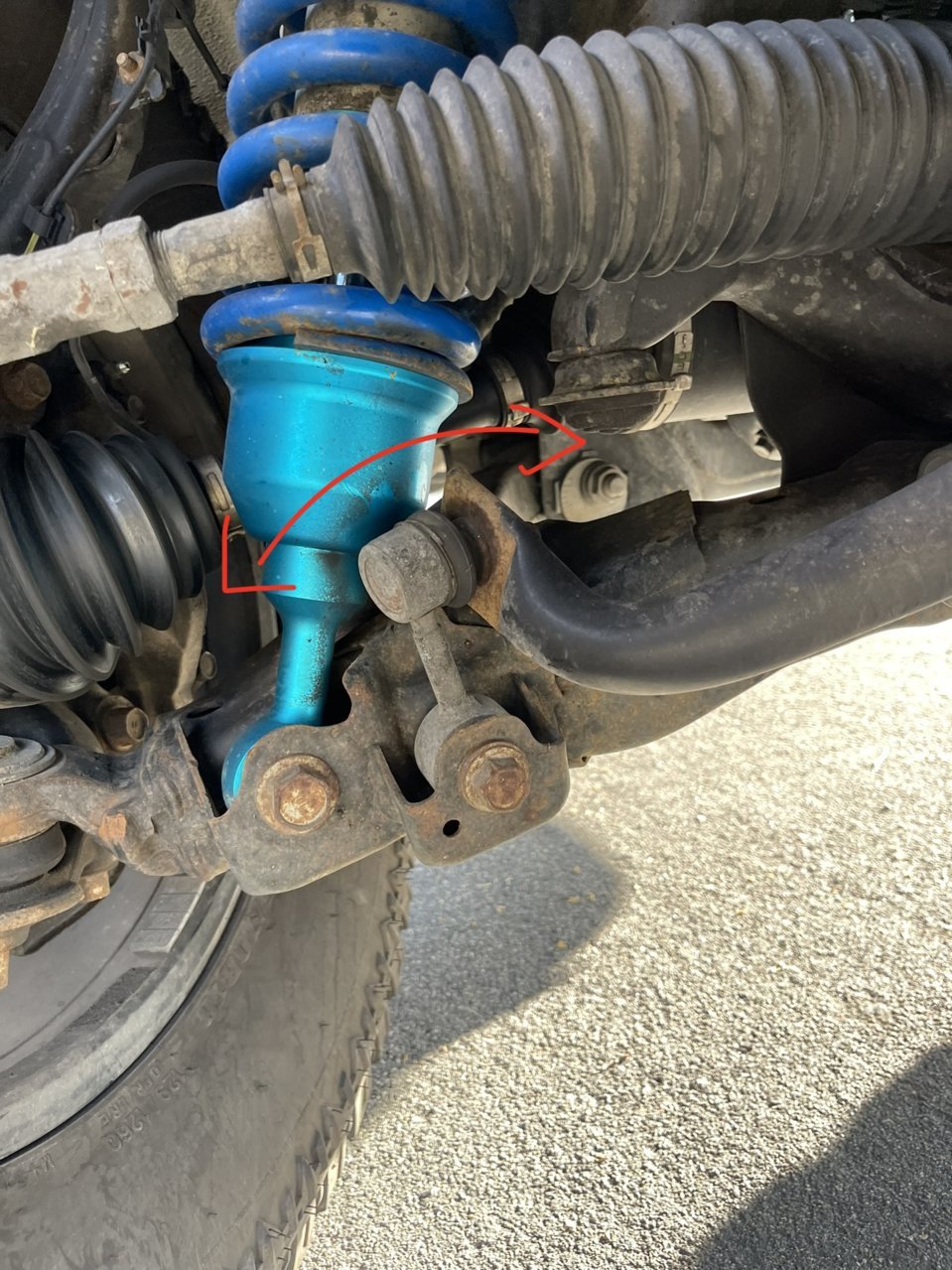

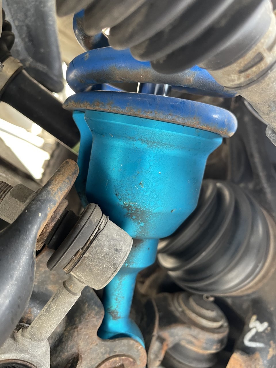

    I’ve tried to find the chips you’re talking about but don’t see them. I did find one nick near the sway bar, but it’s not the sort of damage I’d expect to see from so many repetitive thunks. Looks more like a tool scrape…
    I was able to recreate the thunk parallel parking on my street. Wheels locked full left. One thing I can’t remember, did the thunking happen when I completed the turn of the steering wheel or when I accelerated. I’ll try again.
    In the meantime, these photos are from right after the thunk. I stopped in the middle of the road and climbed under the truck! Haha

    Imgur is easier to share the rest of the photos. I couldn’t see any evidence of what happened to cause a noise.
    https://imgur.com/gallery/2GxnFNB
    Does the sway bar sort of pivot? Am I hearing it fall from one side to the other?

    It’s ur right side tire hitting the sway bar, cause it to shift left

    Look at the back side of the tie rod end to see if there is any evidence of contact to the spring where I circled. Might need a mirror and light to see really well, not sure. Or just turn it full lock and take a look.

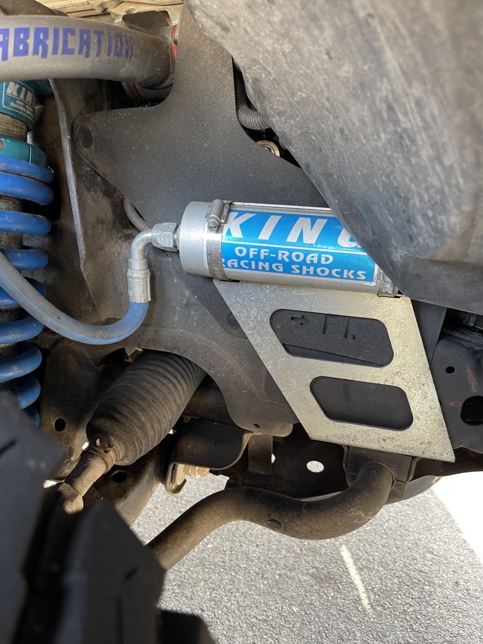

    Don't see any bump stop extensions, do your shocks bottom out before you hit the bump stops? I sure don't see any contact marks on the lower control arms. That makes me think you might have a busted shock internally

    After parking I took the wheel full lock to the left. Heard the thunk nearing full lock. Went back and forth 3-4 times and could not recreate the noise.
    I should be able to see the different orientation then after it thunks, wouldn't you think?
    I couldn't see anything at full lock but I'll get out my welding inspection mirror tonight and see if that gives me a better view.
    I haven't installed anything for the bump stops up front yet. Agree they don't seem to be making contact. Hopefully they aren't busted, that would me a real bummer. I'm planning to get them serviced by accutune in the near future though, so they'll take a look. I don't think that would be responsible for the noise though, right? Because this morning I was totally parked and not even moving.

    Bumpstops for this setup are not necessary. Installing them would neuter the up travel during compression.
