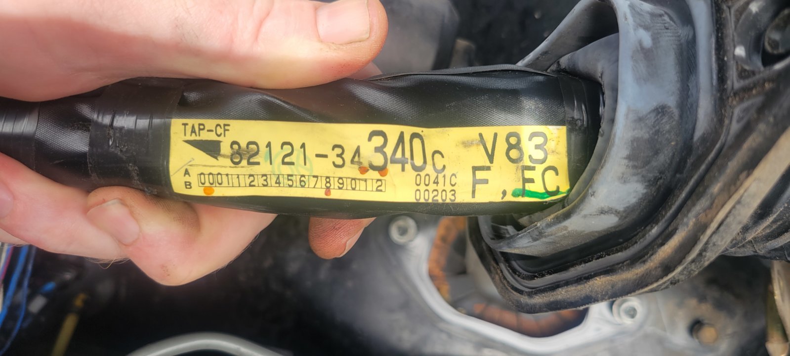

    If I need a whole new engine harness I found a few on ebay but they are all for 2wd. Mines a 4wd will they still interchange?
    Does this # on tag mean I need the exact one?
