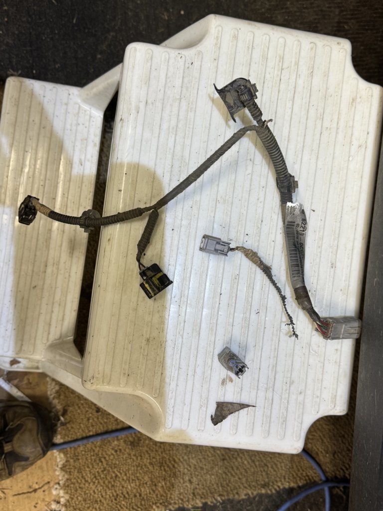

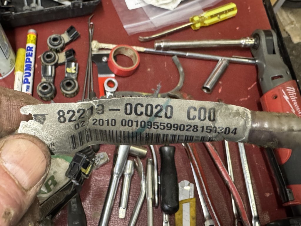

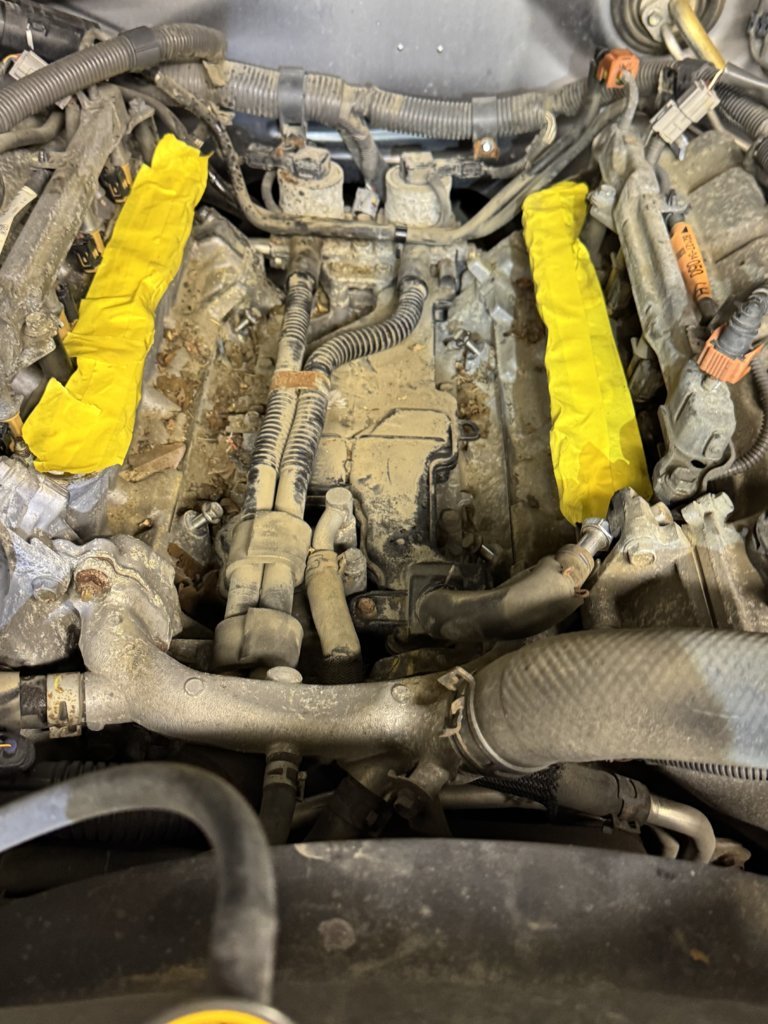

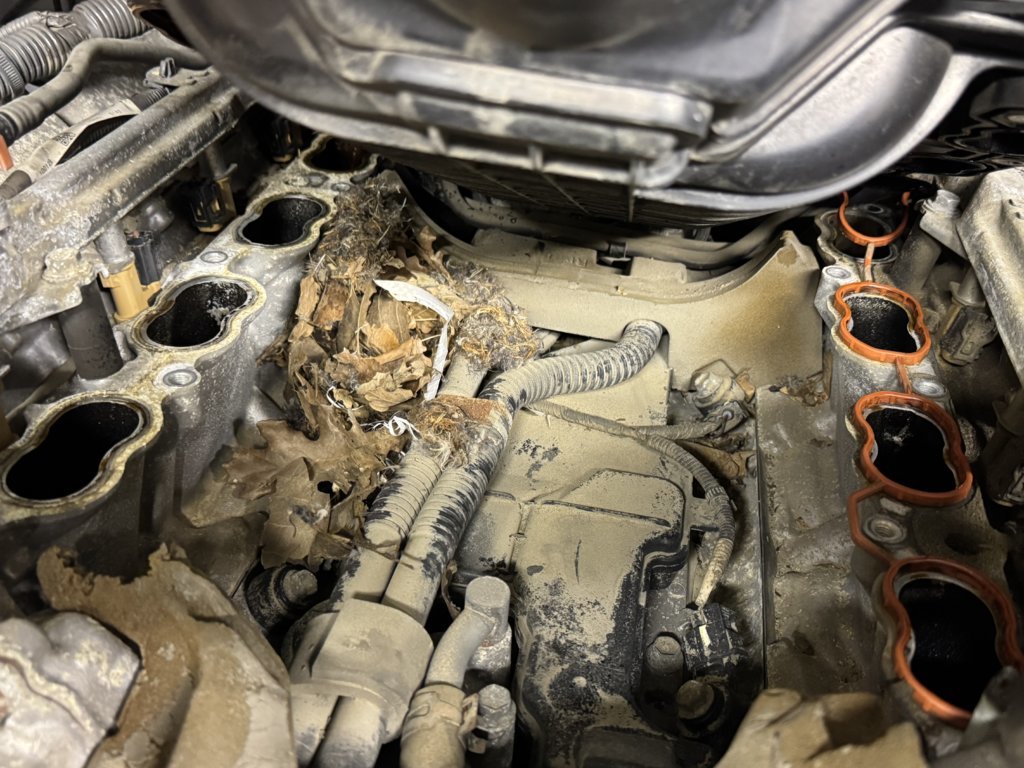

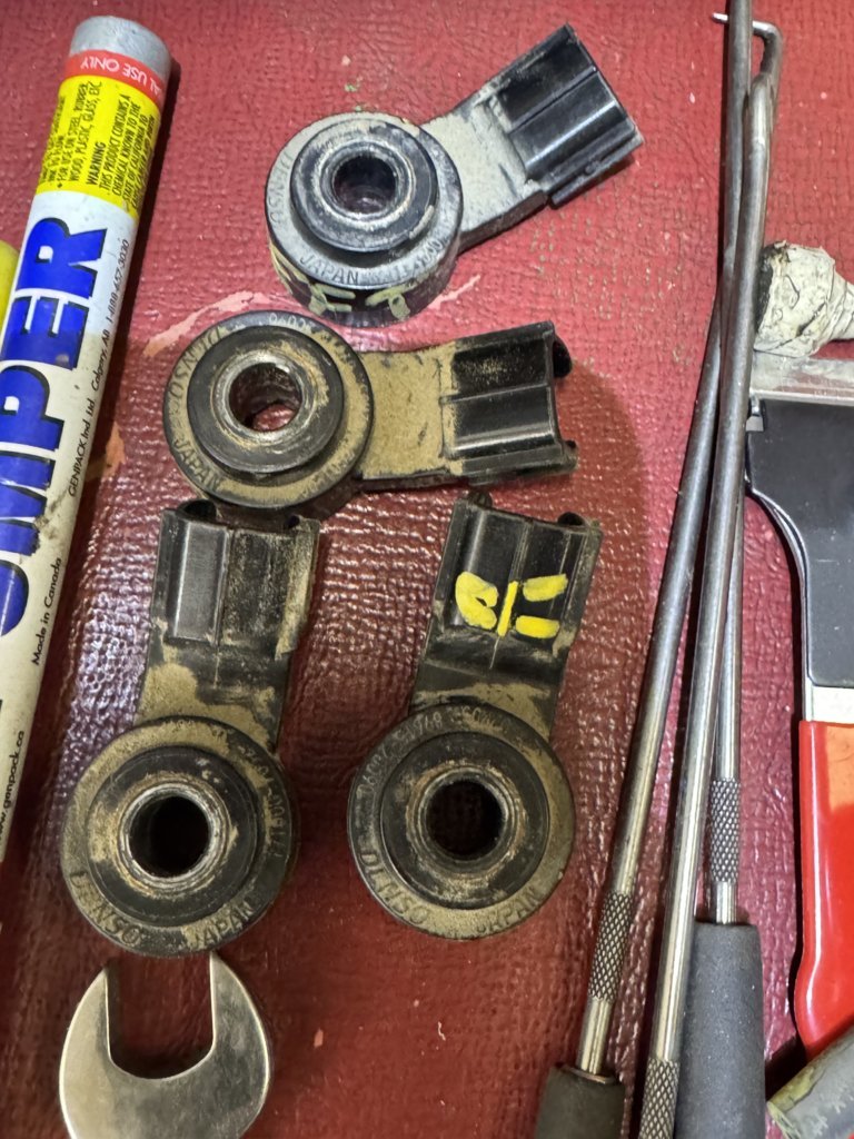

    I did my own harness replacement. It really wasn’t that tough. Wires were destroyed by rats. But I put each sensor back where I got it and the wiring harness was new Toyota from Amazon for $19. It went where it was supposed to go. No brainer at the time.

    We have same motor. Year. 2010. I found part number for harmess on old one. Sensors are identical so someone actually told me to move them around to identify possible sensor error. But mine were not damaged so I cleaned them and put them back. But don’t use some generic wire harness. Get the proper Toyota one. They are stupid cheap and that’s the best way to ensure it’s proper
