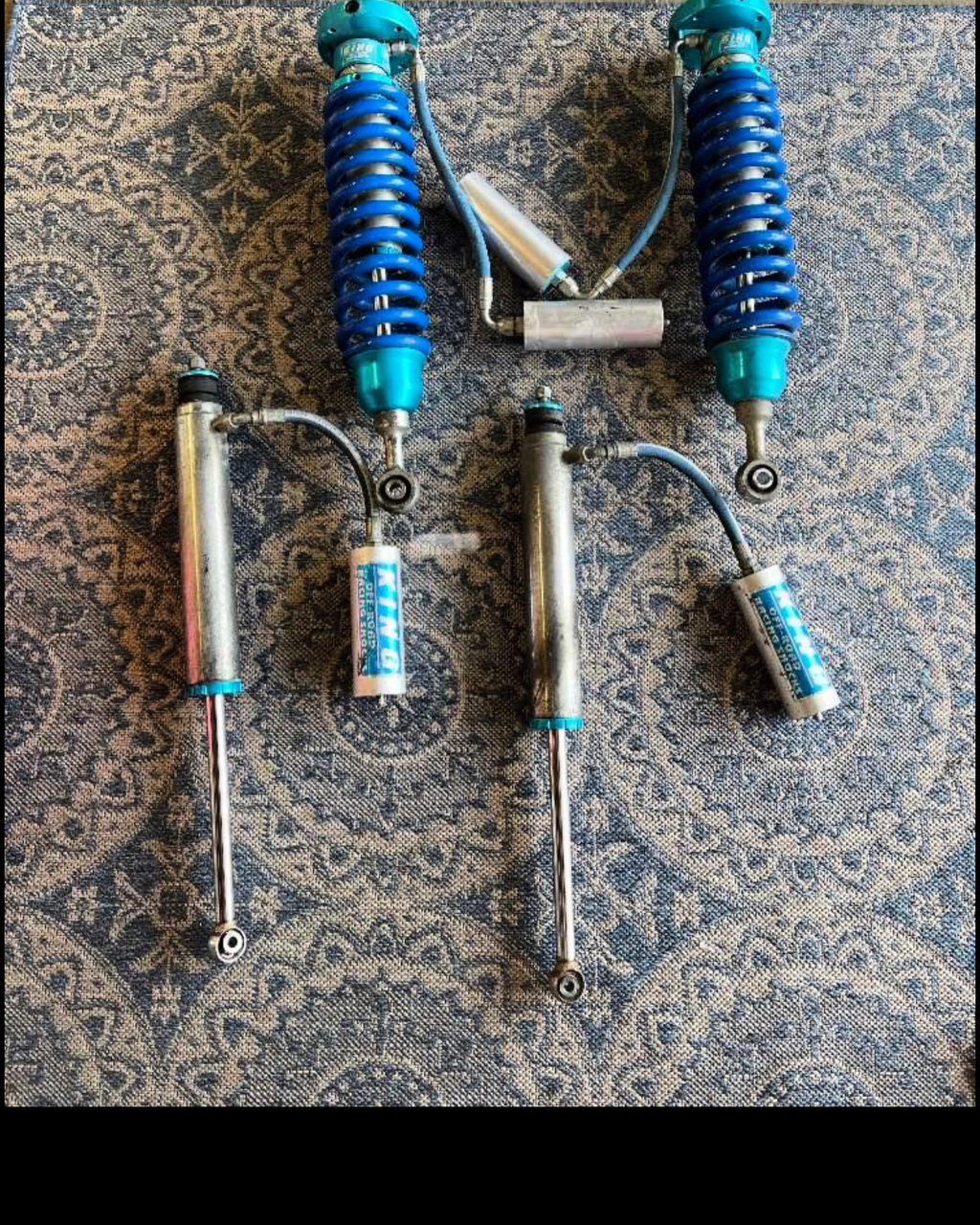

    Sup Fellas,
    Going to buy some used front and rear kings 2.5 with resi no clickers. The seller put 40k miles on them and no signs of leaks. At what point should I take them in for a rebuild? Can I add clickers to these? What’s a re valve be a better option over a rebuild?

    -Rebuild intervals vary depending on use. Buying them used with 40k miles, definitely have them rebuilt and checked out (something we are happy to do if you would like)
    -We typically try and steer people away from buying used, unless you are getting a killer deal. Often times a simple rebuild turns into a very expensive rebuild. However, with lead times these days... may not be that bad of an idea depending on price.
    -You can add compression adjusters, however its pricey. $3-400/each.
    -Revalve is not much more $ along with rebuild if you go through us.
    Shoot me a PM if you have specific questions, happy to help!

    I ended up taking them to DC shocks in San dimas after picking them up because they were on my way back home. Had them check them out visually and they said they looked good, Rear shaft rods had 2 small pits on each but all the way at the bottom were the shock doesn’t compress down to. They said I can go another 20k from the looks of it before a rebuild and when I do the rebuild to change out the shaft in the rear. I got them for $1200 so I can’t complain. The guy I bought them from put 30k miles on them mainly highway miles.
