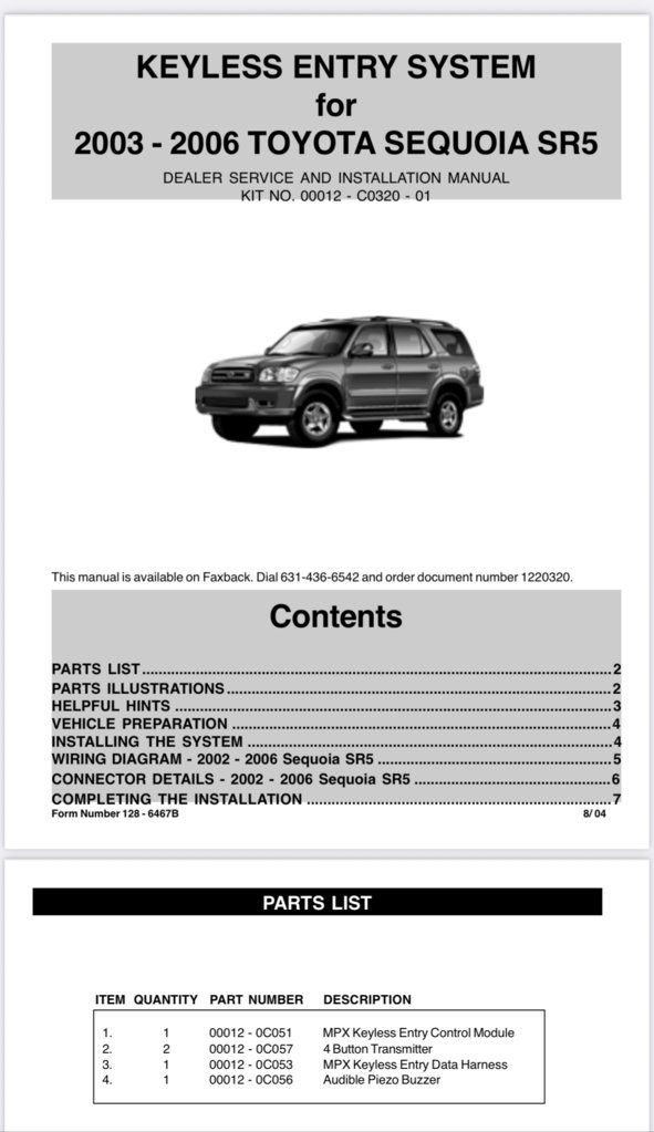

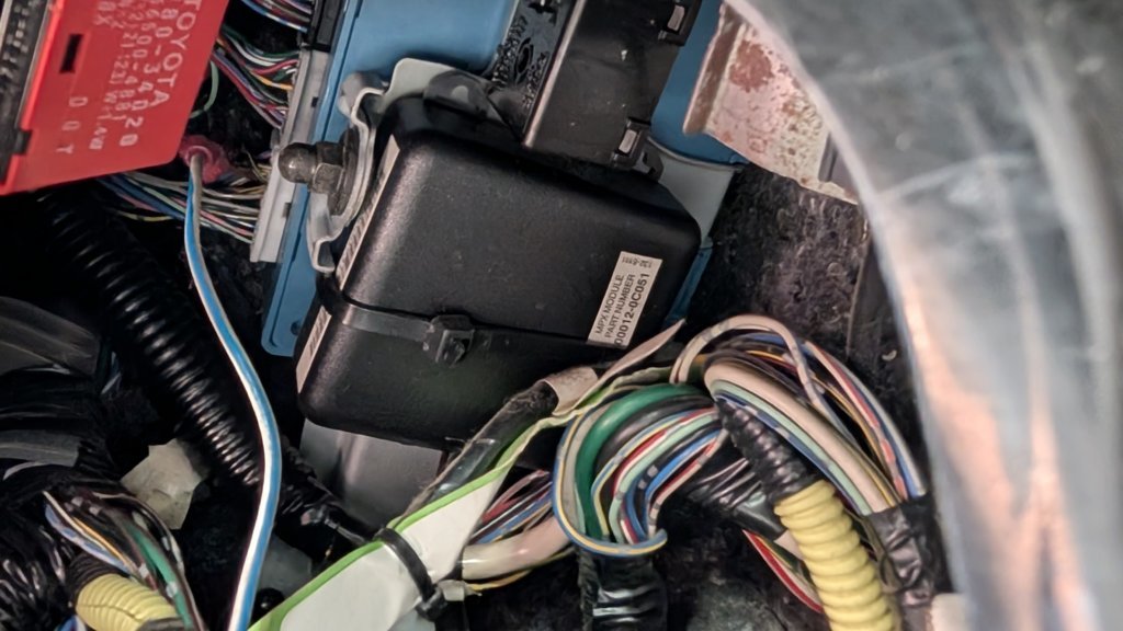

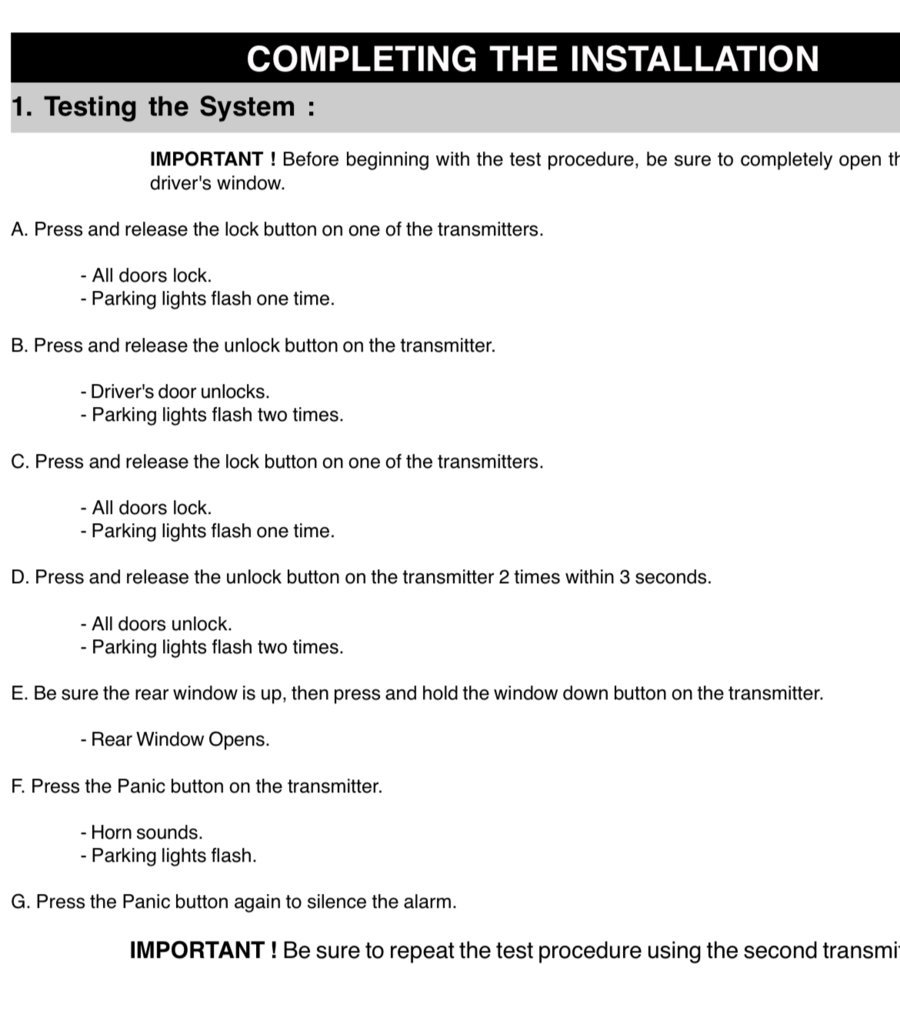

    In this case, I'm trying to have (or reactivate) the keyless entry on my car.
    It's a 2006 sequoia SR5, and I know that AT SOME POINT OF ITS LIFE, this car had keyless entry (here is an add I've found with my VIN, of my car sold by a dealership https://samsdiscountautos.net/vehicles/821149, you can even see the keyfob hanging on a picture, and it's listed in the description).
    The thing is : I only have 1 key now (+the emergency unlock key) and no keyfob to open it from outside.
    What can I check to know if the keyless entry module is still present ? And should I go to a dealership to get a new key + keyfob and a programmation?
    I have tried to make it enter programmation mode, but the car just doesn't want to (all my actuators are working great, all doors opens and closes fines).
