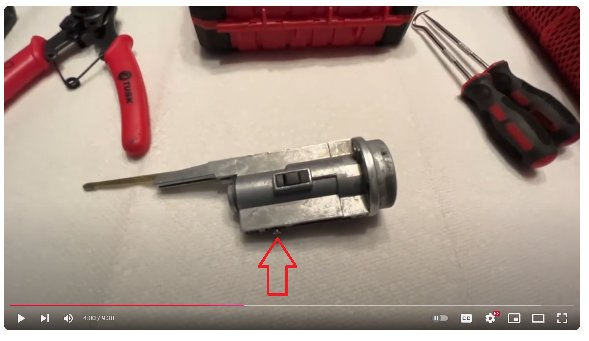

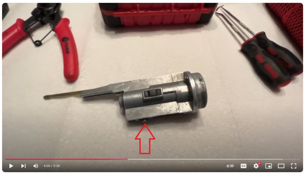

    This is a total guess here... but an educated one.
    Watch this video.
    https://www.youtube.com/watch?v=mrQUOqI_m8c
    At 3:30 he shows how he pushes the plunger in at the bottom of the cylinder to get it out. The key point here (pun intended) is that the key needs to be in the ACC position for this plunger to be pushed and the cylinder pulled out, so if that plunger is pressed in the key can't go past the ACC position. I'd remove the lock cylinder per the video, and carefully inspect the area of the housing where the lock cylinder slides in. For reference, this pic shows the lock cylinder out and the arrow is pointing to the plunger. With the lock cylinder out and key in it, does it turn to all positions -- including off? Can you press that plunger in when the key is in the ACC position?

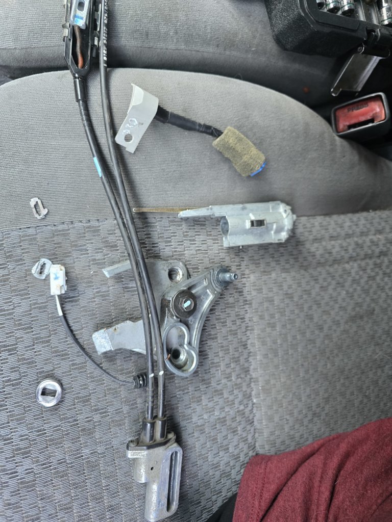

    So I removed the cylinder again and tried to manually turn the metsl rod inside to a lock position (Horizontal) but it wont go all the way. My guess is that it has to do with the Parking Gear.

    I that your new lock cylinder?

    Those are all damaged parts I already replaced

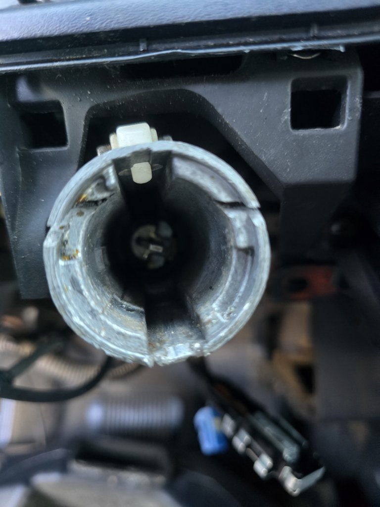

    I hoped that was the case, since the lock cylinder and wafers were all disassembled.
    Looks like everything is clear for the plunger at the bottom of the cylinder.
    If I remember correctly, the long lever shown here engages with the shifter mechanism. If the shift lever isn't in Park, the key can't be turned off. Look back down the housing in the above pic while moving the shift lever. See if everything looks right.
