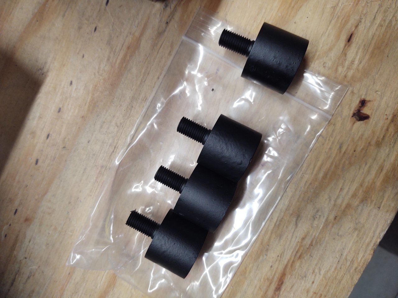

    I don't have the bump stop spacers on mine but want to add them. Can anyone please measure the size of the spacer. OR take a pic so I can get an idea what I need. Is it a special spacer? OR is it something that I can probably find similar (like a big washer) at home depot or something? Thanks

    These are the ones that came with my kit. 1" spacers with male and female threaded ends.IMG_20200728_174524383.jpg

    Whoa, what kit did those come with? The ones that came with my 5100 kit were basically fender washers, maybe 1/8" thick max.

    They are Boss4x4, with my 6112 kit. I upgraded and ended up not using them.
