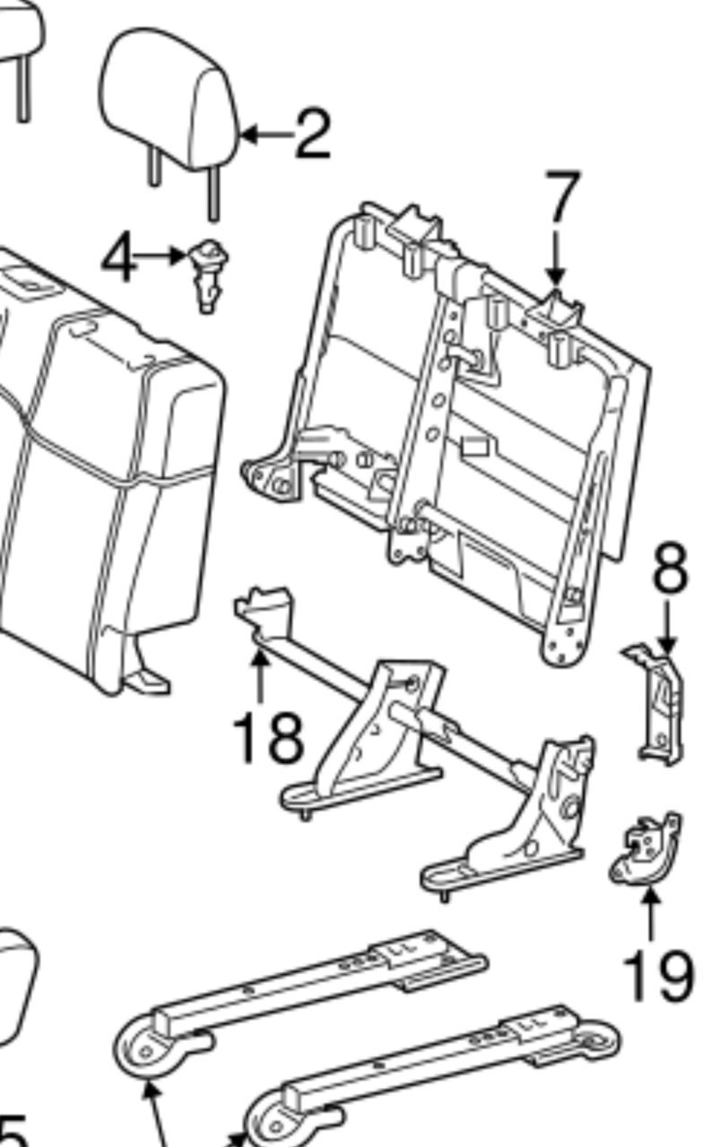

    It was a pain just figuring out how to disassemble the seats. I ended up leaving the cable attached and kinda leaving them together.
    When I was putting the new cover on, I got all the clips on the back seated.....realized I didn't do any of the hog rings.....i amaze myself sometimes.
    I got to a point where I have to remove the seat flip bracket and stopped, do you happen to remember how that comes off? I think I'm going to try to do 1 panel a day.

    I might remember. Which “seat flip bracket” part are you referencing? The metal latch that holds the seat down or up had two 12 or 13mm nuts. The plastic handle trim just took some gentle prying.
    For hog rings I got to where I would load the ring, hook the top edge around the bar in the cover, then use the pliers to push the ring and cover down to the bar in the foam.
  26. Oct 25, 2020 at 6:26 AM

    The one to lift the rear seat. The one that the release cable is attached to.

    You removed those? I never did...

    There are two nuts holding them on (one of them circled in yellow.)The lock assembly is number 19 in the diagram below. I think I removed it and left it attached to the cable when separating the seat halves. But in hindsight I think if you pop the plastic cable holders (circled in orange) out, it should give enough slack to get the cable end out of the lock assembly.
